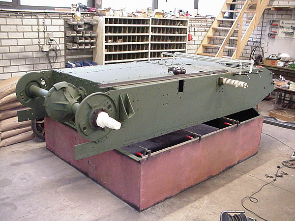

The restoration of the Windsor carrier at the Liberty Parc in Overloon (former “War and Resistance” museum) is almost finished, so it is time to move on to the Conger carrier.

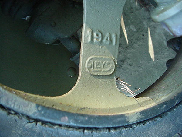

After inspection of the running gear, it soon became clear that it was in better shape than the gear on the Windsor carrier. Soon the track loosened up and the carrier was able to roll again.
