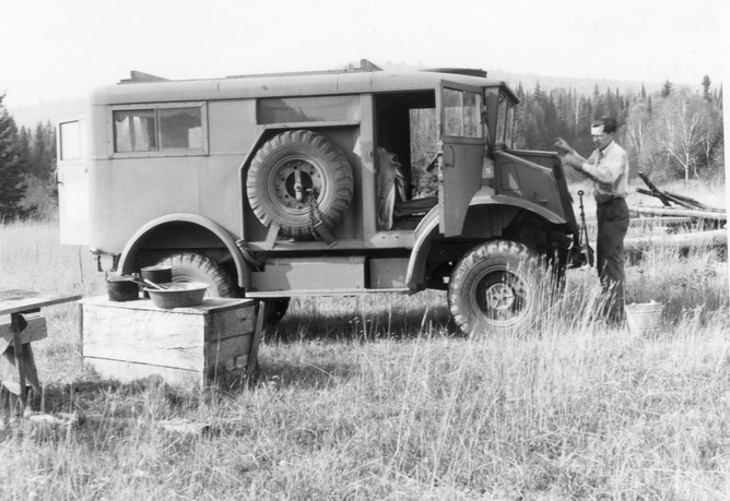

This is an invitation for all web-surfers/restorers/researchers to post shots of non-military use HUPs with the intent of sharing information and perhaps populating a future HUP section on this website...
Here is my first offering (taken from: http://www.lib.duke.edu/forest/Publi...01/drushka.pdf)
RHC

Steal?? Nay! I say. Proper credit was given - see edge of photo. The attached URL in my original post leads to a newsletter that describes the forestry service somewhere in Canada. Chances are, the HUP is still sitting in an alder swamp between the Soo and the Miramichi (just to narrow it down)...we will track it down when I collect my lotto winnings (note to self: don't hold breath...).
Phil, some would say NY is "strange" - so, yes! Your shot qualifies - looks like a lonely petunia in the onion patch tho!
Jason Ginn's find should be added to this thread.
More shots to follow!

Jason's HUP find:
RHC

In all of the HUP pics, the towing lugs are mounted horizontally vice vertically in all (?) other CMP types.
Was this a common feature of HUP production?

Default HUPs ARE DIFFERENT
Jon,
My 43 HUP wrecks have vertical D rings. The 45 - horizonal. Other differences between 45s and earlier models (others should feel free to add to the list):
- Different frame in regard to the number of cross members, width and length
- Sliding roof hatch mounted forward on the roof
- Sliding windows mounted in metal frames (the small "opera" window on the drivers side is held in place by small metal cleats
- Complex passenger running board that includes a lockable Jerry Can holder (for 2 real Jerry cans vice POW cans)
- Elegant step for the front passenger side door
- Space heater for the rear
- Intermediate bench seat in the rear
- Two jump seats in the rear corners
- Rear floor was a strange grid pattern plate (grid down - see Frantisek Nachlinger C8A 1C11 thread for an excellet shot)
- Linoleum flooring in the rear
- Two piece divider frame (upper and lower)
- Upper divider frame has lockable sliding glass window
- Folding desk mounted on the divider
- Different (as far as I know) knee action shock arm length
- "tar paper" insulation on the doors and walls
- Luxurious cardboard liner on the walls and ceilings of cab and rear space
- Chain locker
- On/off switch on rear convoy light plate
- Different front end clip - tighter turning radius meant wider wheel wells
- Towing "D" ring layout
- Motor mounts used for the transfer case - explaining the small hole cut in the floor (see Hammond Barn thread for photo)
- Different length front drive shaft
- Different bumpers/spring cover plates
- 2 inch wide springs
- Different spring pins
- Different front end spring mounts - front and rear of springs
- Different size for both rear axle shafts (making a short axle shaft a really significant find...)
- Lighting in the back provided by one centrally mounted (driver side) lamp
- Inside and outside thru the door handles for all doors
- Clamp type rod activated parking brake on the rear of the diff
- Different sized wheel cylinders front and rear (at least on my HUP...)
- Two rifle racks mounted vertically in the cab and two mounted horizontally above the windows in the rear
- Roll up blinds with snaps on the fabric and on the window frames for blackout purposes
- Narrower brush guard Not so! I stand corrected. HOWEVER! The bolt patterns on the uprights are different due to the narrow width of the bumper itself...
- Hinges on the side and rear doors are unique
- Front bumper mounts are castings
- Wooden spacers are used with the bolt attachments used to fix the body to the frame
- Composite materials are used as spacers between the frame rails and the body
- External civy pattern door handles Oct 2010
That is all I can think of for the moment. More, I hope will follow...

Would you mind posting the photo of CMPs (with HUPs leading) to this thread?
RHC

Here it is with link http://canadianmilitarypattern.com/C...20Columbia.htm for the rest.
