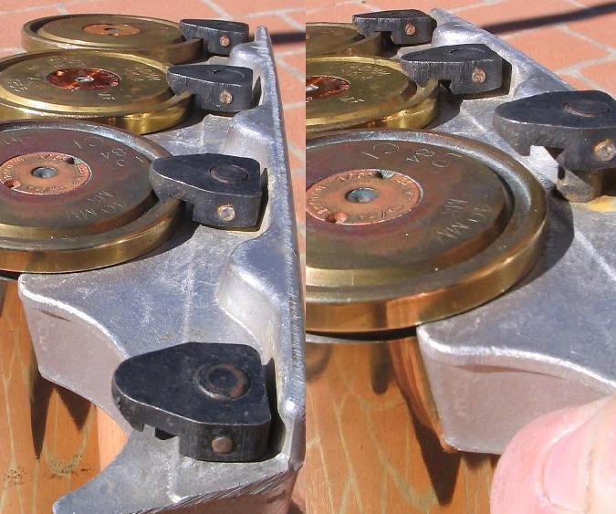

As you said, the rounds ( cartridge + shell ) are in clips of four, each round locked by a spring-loaded hook at the base. Godwin
This shows the retaining claw in the open and closed position:

Originally posted by Godwin Hampton
As the autoloader pulls the rounds down towards the feed rolls, the clip travels in a groove down the autoloader's curved rear guide. This groove becomes progressively narrower at the front, forcing the buttons inward and releasing the hooks' grip on the cartridge. Thus the rounds are one by one freed from the clip. Godwin
Here you can see the clip being fed into the Autoloader, and the ramp which lifts the retaining claw buttons as they are drawn down.
Thus the rounds are one by one freed from the clip, which then falls at the feet of the loader through an aperture at the side of the autoloader.
Godwin
As the full clip of four is fed down into the Autoloader and the ramp lifts the claw, the rounds do not actually separate from the clip until 3 rounds have been unlocked, when the clip is moved to the side.
Two grooves and apertures are provided, one on each side, so that the clip could be loaded facing any side you like. Some British Army guns had the right aperture sealed off, but the reason for this eludes me.
Godwin
When the 4th round is unlocked, the clip falls out the side opening in the Autoloader.
The 2 apertures only seem to have been used on Naval guns, as all the Army Bofors I have seen only have 1 opening on the left side of the casing.
