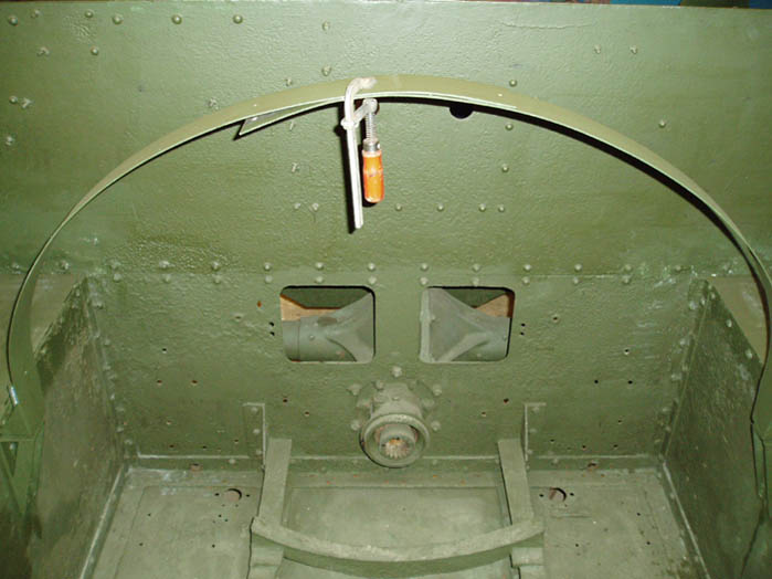

I am looking for some help here. Although I have spent some time looking for old fittings of the Conger equipment in the carrier, I am having trouble finding any. I have to say that some panelwork has been replaced in the past, so some info might have vanished back in the days. of course it could also be that the Conger equipment used holes which were allready there in the "normal carrier" configuration.
Can anyone of you guys have a look at the two attached pictures to see if you can discover any holes/fittings which are not on a " normal" mk1 carrier? Lynn? Jordan? Nigel? Hendrik?
p.s. You can see that the bows for the attachment of the Nitro-tank have been fitted in the meantime. The lower supports on the " engine frame" were still there fortunately.

Old 14-02-07, 02:19
Posts: 4,190
Hi Alex
The work so far looks great. I can only imagine how hard it must be to complete this project when so little is known.
To answer your hole question, I don't see any that are out of place for a Mk1. I would tend to believe that the original holes were used for simplicity. Why re-drill through armour plate when you can use a bunch holes already in place.
Old 20-02-07, 16:51
Hi Jordan,
Thanks for the compliments. The guys at the museum are really doing a good job, especially when you take the limited budget into consideration. Indeed, some things are hard to reproduce, but we did manage to sort most of the things thanks to the information from pictures and from what we got from Nigel Watson.
Good to hear your idea about the use of the original holes. I had another look and there doesn't seem to be any specific Conger fittings on the bottom and rear armorplate, so it sounds plausibel that the original carrier holes were used.

Hi Alex
Was studying the second photo showing the inside back wall of the carrier and there are two holes which aren't on mine. They are either side of the engine frame low down drilled through the angle iron. They are not drilled out rivots as they appear to be in a different position. My MkI doesn't have them and before anyone asks I don't have a fuel tank in the way on one side!! and no hole through on the other. Just holes in my overalls from clambering along the cold concrete floor!!
Nigel

Nigel,
Good point! Kind of sad that I didn't notice these holes myself!

HI everyone
Nigel, I think those holes are for the rods that control the brakes.
Old 22-02-07, 18:52
And good point, Jordan!
You're right. I had a look at the pictures from the beginning of the project and indeed the brake-rods ran through these holes...

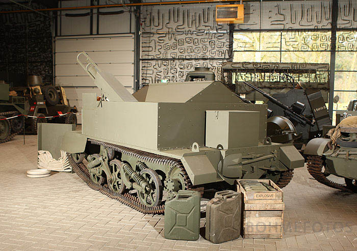

I just received word that the Conger has been added to the exposition again! Hurah! After months of work the project is about done; just some lettering, accessories and possible replacement of little components.
Over the past two weeks the hose up front was fitted, the firing box was finished, the hand paint work sanded down and a fresh coat of paint sprayed on.
The carrier was "carried" from the workshop to the exposition, rather than "driven" on it's own tracks, to avoid stress on the track-pins.
I will be taking a look myself in the next few weeks.

DONE!!!
A few weeks ago we visited the Overloon museum to see how the last stage of the Conger restoration turned out and to see the finished vehicle in the exposition, rather than the workshop. My good friend Tim Böhme, a car race photographer, who also has a great interest in WW2, came along for the ride.
This thread started with the sentence “The greatest challenge will be bringing the Conger back as close to its original configuration as possible, within the museum’s budget”
Funding these sorts of projects always is a great struggle for a museum, especially when you consider that they are only possible when enough entrance tickets are being sold. So, in stead of ordering all the parts outdoors, most of them were fabricated indoors; with a lot of ingenuity and hard work the 8mm steel plates were produced, as well as the launch tube, plumbing etc. This meant that the project took longer than the projects the museum is used to, but the staff was very patient and also very determined to do this sole Conger survivor justice.
I think the volunteers at the museum really did a great job and it shows what can be done with a limited budget. Together with them we turned a section of the museum into a small photo set. Tim took a series of pictures, three of which are displayed below.
Soon the Conger will get a sign next to it, but visitors that day were already very interested in this unusual vehicle....especially when they heard that we believe it is the sole survivor of the 5 or 10 (?) vehicles initially converted by Chubb in Wolverhampton.
I will post an impression of the 3D CAD work I did for the project in the next few days. This will give an idea how we determined location of fasteners and some of the measurements.
A big thanks to all the MLU members that helped with suggestions, pictures, expert advice, information etc. A special thanks to Nigel Watson who helped us to find the original provisional working instructions!
Please enjoy the pictures!
