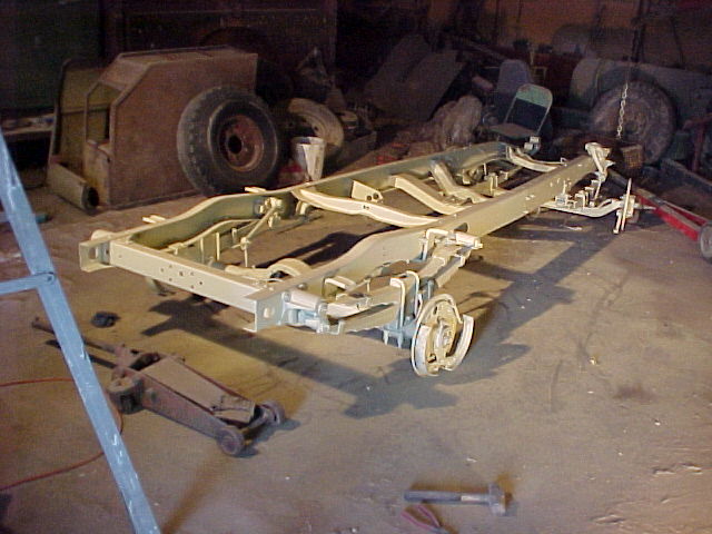

Here's the blasted chassis ready for some paint.
Old 06-03-07, 04:35
Here it is after three coats of light stone paint. I used self priming corrosion resistant low lustre General enamel.
Note the overload springs. Were these common on 8 cwts? They were painted khaki before but they don't look like they were installed at the factory. Where the front stopper is bolted to the frame it's over the square washers on the shock absorber bolts. The other side is the same way. I don't think the factory would have done it that way.

As far as I know , the over ride springs are a post war add on by a civilian ? They are not mentioned in the parts book anywhere .
Its looking great . I sandblasted my chassis as you are doing . Make sure you use good hearing protection . The loud air rushing noise ( white noise cos its full of harmonics ) , is extremely damaging to your ears , you can end up with tinitus, a permanent ailment, for the rest of your life , no cure known for it .
The rubber spring stop blocks on the chassis, I found nos ones years ago at Hancock spares in Camberwell , where Keith Webb worked . I noticed they don't line up too .... weird isn't it .
