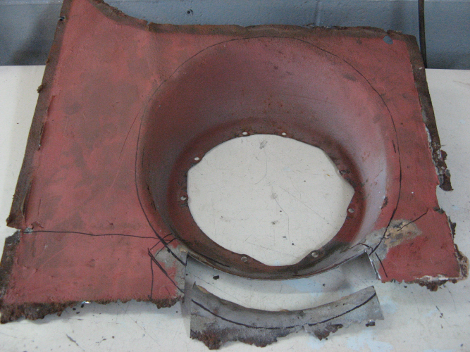

This piece that Bob cut out was just too rotten to use. He got a piece of 1/2 inch rod and bent it the same radius as the headlamp pocket. He clamped it in the vise and bent another piece of metal around the rod to duplicate the shape of this rotten piece.

Here you can see where the new piece has been welded into the headlamp pocket. The thin line you see is where the new piece meets the old. The welding was done from the back so that you don't have to do any grinding on the front side. Notice how the Mig provides super penetration when you are a good welder. Notice also that I am not doing the welding and that is for a good reason.
The headlamp pocket was cut out of the old panel and then measure, measure, measure. The new panel was cut out and the headlamp pocket was fitted to it.

Thanks Bob and Barry for the excellent tutorial on sheet metal repair.
all kidding aside the quality of the photos and the running commentary is better than what I have seen in some welding video or books. Your postings are teaching a whole bunch of us how to do it.
