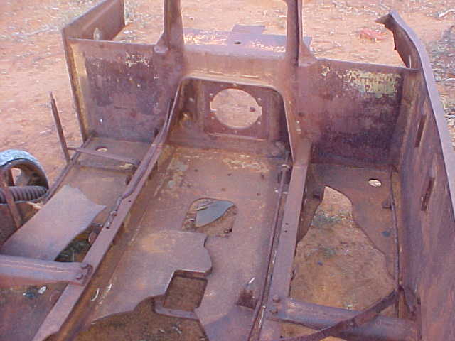

Default floor
notice just how brittle the floor must be

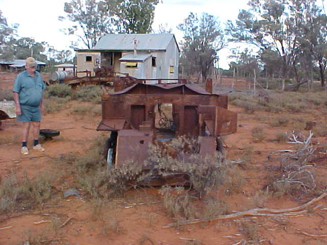

Default L P 2,
This is the other one at the same place
Ron Winfer
Old 10-05-07, 12:17
ron ron is offline
Posts: 1,294
Default station owner
Another angle with the station owner in the pic

Posts: 4,189
Im not trying to hijack this thread but what would cause the floor and front bow plate to fracture like it has. Had it been through a brush fire?
Just wondering as I have never seen that before.
Old 13-05-07, 09:05
ron ron is offline
Posts: 1,294
Default cracked floor
Hello Jordon,
No they had not been through a fire all of the rubber is still intact, its mainly to do with the type of work that they were used for in this area where they are, they were run up to small trees( Mulga trees} in time of drought and used to push the trees over so that the stock who had nothing else to eat could eat the leaves of the trees, and more often then not they bottomed out on rocks, if you do this often enough the steel as it is hard will crack, I have seen many of these carriers with holes in the floors and very large cracks, although this South Australian one i
s by far the worst example that I have seen
Ron,
PS, Jordon as you can see rust is not much of a problem,

Old 13-05-07, 13:02
Poppy's Carrier Poppy's Carrier is offline
Matt Baker
Join Date: Dec 2006
Location: Ipswich QLD
Posts: 26
Default S.A.R 2522
Gday ron,
Another S.A.R. discovery 2522, this carrier is rather close to my S.A.R carrier 2564, what i also found interesting was the cracked hulls, my carrier has had a lot of cracks welded up in the hull , i assume that this was done to it while in service as i couldn't see a farmer welding it up. The welds on my carrier appear to have been done with stainless rods, was this usual for the army?
Cheers for now.
Matt Baker
Old 13-05-07, 13:29
ron ron is offline
Posts: 1,294
Default Welding
Hello Matt,
I am glad that you bought up this subject of stainless steel welding, I had forgotten to mention it in the original posting, If you have a good look at Picture #6, you can clearly see that the original welds are done with stailess steel rods as are all of the original welds, some of the on farm or station welding has been done with normal rods(not stailess) its not possable to see the front part of this carrier interior to well but all of the original welds are the same, I have seen this before in the South Australian carriers,the welds I am refering too are original welding,I only mention this to you as an observation that I have made over 30 years or so ,and to be fair any other conclusions can be drawn by the reader, these little bits of information are what makes our hobby all the more interesting, maybe some of our South Aust members might like to comment?
