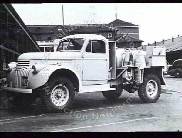

If you look at the first AWM photo Mike Kelly put up you will see it has the same additions to the chassis.
