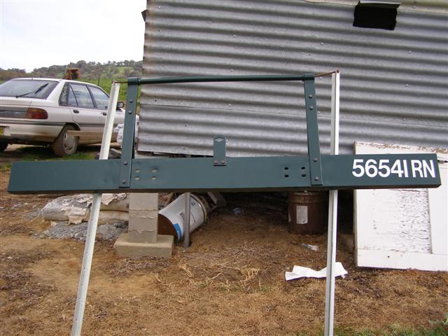

Posts: 1,958
bumper removed for straightening it is a ford bumper but I have learned to live with it
Old 19-08-07, 11:35
Euan McDonald's Avatar
V.M.V.C Member
Posts: 627
Default Ford bar?
Hey Robert,
I would live with the bar you have as it looks very Chev too me, Its got the correct brush guard & hole spacings, just needs a little work in a workshop press.

Old 19-08-07, 11:49
hrpearce's Avatar
hrpearce hrpearce is offline
WO8 C15A 142736
Posts: 1,958
Default Euan
I know the brush guard is corect but the 56541RN number on the bumper is off a Ford that went to New Guinea.
Dont have a press so a bonfire and 10 lb. hammer will have to do.
I need a pair of towing D's for the front if anyone has spares?

Default Bumper straightening
Robert: try driving over it lengthwise with your tractor... it worked fairly well with one we had in Shilo many years ago but I admit we cheated and used an M113 for the "hammer".
Good luck with the restoration!

Old 21-08-07, 01:19
Default Straightening bumper
I’ve straightened two bumpers using the same method, dig 2 foot diameter hole in ground insert 2 in pipe connected to exhaust end of a shop vacuum cleaner, dump in 25 bag of charcoal light the charcoal turn on the blower and wait for the blast furnace effect. Once fire is going well put the bumper on to heat the bent section, once it red hot then you are ready to straighten. Tried sledge hammer, problem dents the bumper. Then I drag a steel I beam out and used a rail jack chained down to the I beam to straighten the bumper. Took about three heating cycles per bent side to press the bumper straight.
I’ve have noticed however that the straighten bumpers seem to bend again easier.
The later model Pattern 13 bumpers seem to be made of standard C channel steel beams so check with your local steel dealer you may find that he has the correct channel in stock.
As for the bumpers for the earlier designs which are bent out of 3/8 sheet steel, I had one made from my Pattern 12 at the local steel fabricators.
Old 21-08-07, 01:44
hrpearce's Avatar
WO8 C15A 142736
Posts: 1,958
Default Phil
Thank you for the tips. I too use a vacuum for air blast but I usually light a pile of rubbish tree loppings and start work when it burns down to coals. I hope not to bend it again after it is refitted it was bent in the first place by bush drivers using trees for brakes.

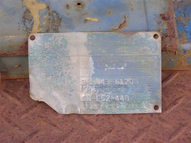

WO8 C15A 142736
Posts: 1,958
Question But
in the rubbish built up under the drivers seat I found a data plate from another Blitz .
WO 48
chasis 3844361206
engine PR 3946697
order SM-E52-448
date of manufacture 13 9 44 AUS S

Old 19-09-07, 04:39
Default Re: Engine cover
I've started work on the engine cover, the one out of the doner blitz is in the best condition but I will be using parts off all 3 to get one I am happy with When I unbolted the rubbish off the top of my cover I found this damaged instruction plate and the transfur box changing instructions are not what I expected Has anyone any information on this as the manuels don't show a low/4WD change with a single leaver and my blitz is not set up this way
This is because the plate comes from a C60L, 8443 chassis which has a two speed transfer case.
WO48 was the designation for a "Stores unbinned" body for delivery to Armoured Division.
What is unusual about the data plate is Sydney built trucks usually did not have the date stamped there - it was usually on the gearshift plate instead.
