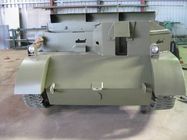

Posts: 1,810
front view for those who noticed that I had the gunners side light mounted in the wrong location. Now its not. By the way I repainted averything the correct colour. Thanks Ian.
