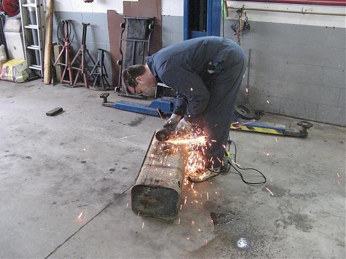

The first photo is a fuel tank with the end cut out. This one was previously coated on the inside. That is the baffle at the bottom.
The second photo is the cut off end. We need that filler neck for the new tank.

This is another tank that will donate more hardware for the good tank. The sparks from the grinder ignited the nests of who knows how many generations of mice, snakes and hornets. We should have had hazmat suits.
We need the reinforcement ring under under the sending unit.
