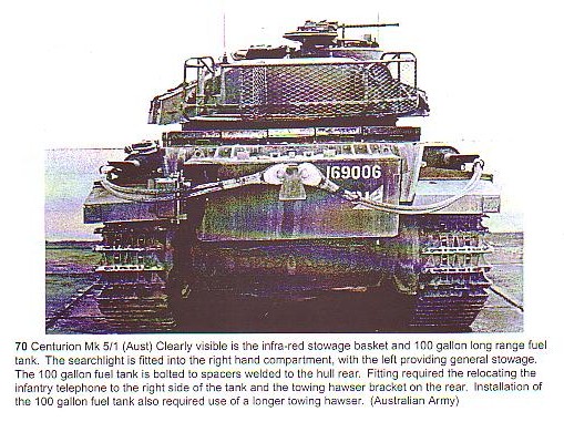

Old 24-02-04, 12:11
Default Australian Centurions
Shane Lovell (who has posted on this forum before, see http://www.mapleleafup.org/forums/sh...&threadid=1496) has put out a great book on Australian Centurians in the Vietnam era. Many of the modifications to Canadian Centurions were of British origin and also applied to Australian Cents, too.
Contact Shane for a copy of his book, but I'll show a couple of detail pics here.

Old 24-02-04, 21:54
Philliphastings's Avatar
Join Date: Feb 2004
Location: Sydney Australia
Posts: 549
Default Centurion Searchlight mounting point
Hello,
I owned and restored Australian Centurion 169-129 in the late 1990's and fitted a new out of the box Philips-Usffa searchlight assembly (which like the vehicle itself came from Tim Vibert)
The mounting bar is attached by two (or maybe it was three?) large HT bolts which tap into the gun mantlet plate itself. The mantlet cover sould go on over the support bar as there is provision to zip the cover over the large end of the bar when the searchlight is stowed away to keep the mantlet weather and dustproof.
All the parts were still in their tropic proof packaging and I had, for a time the only fully IR capable Centurion in private hands in the country...
What fun it was to acquire cow 'targets' at midnight in the top paddock after midnight.
Phill Hastings

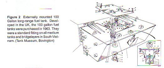

Question 100 gallon fuel tank
Hello:
Does anyone have more detailed pics of the inside of the top hatch of the external 100 gal tank? I'm building a model of a Centurion using AFV Club's Centurion Mk 5 kit and I'm converting it to a Canadian service Mk 11 LR. I was going to pose the hatch open and need detail of the 'stuff' inside and associated connections etc. Was there a through-hull fitting for the fuel line from the tank to the vehicle or was it an external line?

Old 09-08-06, 02:05
Chris Johnson's Avatar
Chris Johnson Chris Johnson is offline
Cdn Armd Corps In WWII
Location: Ontario, Canada
Posts: 61
This image might help you a bit, but I don't have a shot of the inside of the cover, only the outside.
Chris

Old 09-08-06, 17:06
NebLWeffah's Avatar
NebLWeffah NebLWeffah is offline
LCdr Bob Read
Join Date: Aug 2006
Location: Calgary, Alberta
Posts: 8
Default 100 gal fuel tank
Thanks Chris - exactly what I was looking for. I'm assuming the tube is the fuel line leading from the tank into the fitting on the vehicle?
