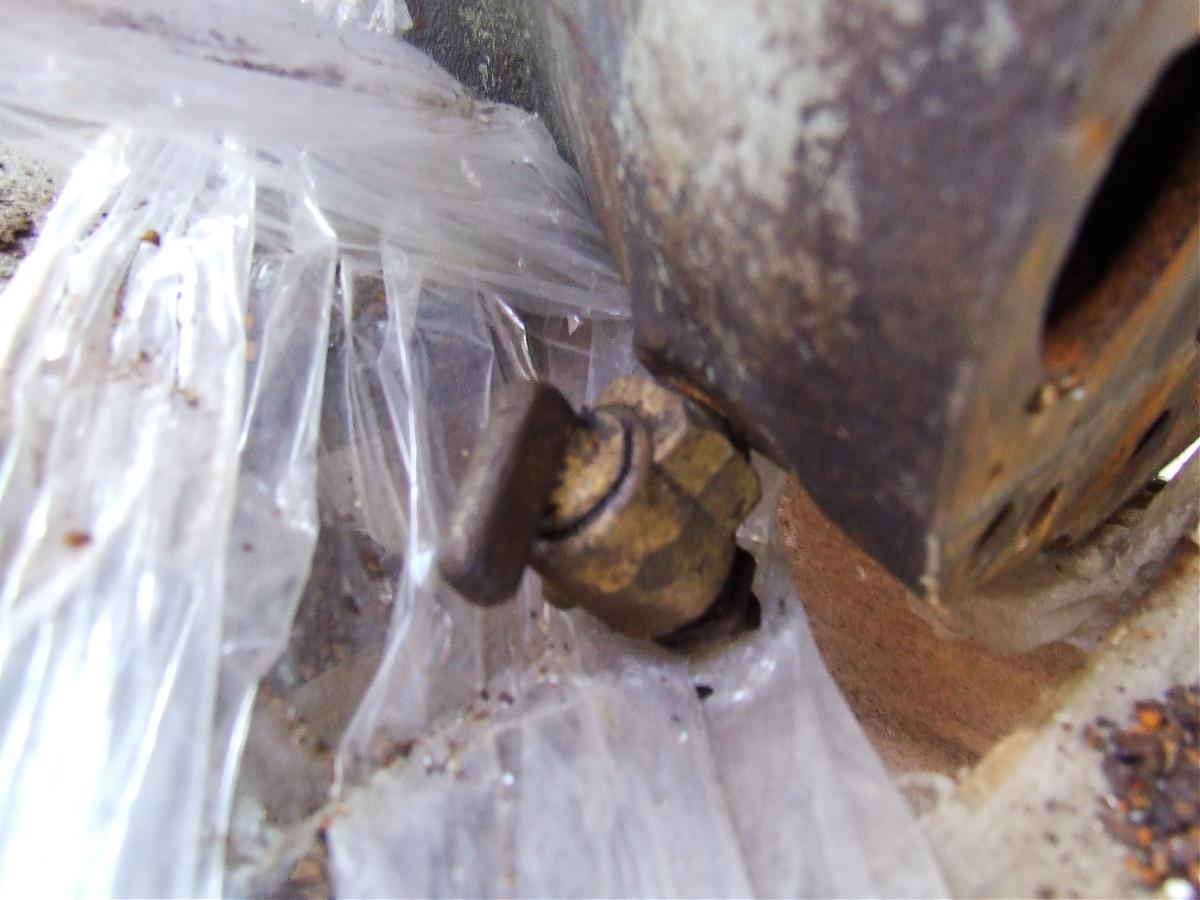

Can you post some pics? Also you pic of the block front will not blow up.
I have just read about the drain pipes for the water cocks being attached to the sump. Do you have that detail?

Hi, More pictures of the Engine, Anyone got a sump for this engine. Block drain taps shown, not on the sump?.
