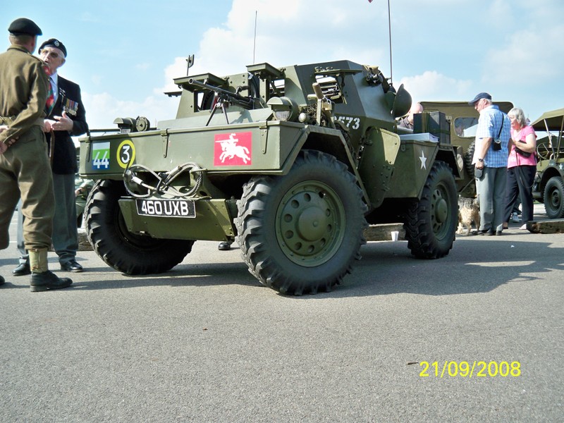

Someone find a solution for the Ferret tyre problem?
Pic source: HMVF
Old 22-09-08, 00:47
Hanno,
Dingo actually This owner has found some 7.50-18 tyres, normal size is 7.00-18.
I have fitted some 7.00-18 truck tyres to another Dingo, with good results, apart from visual appearance of course. Tried to get it stuck in Beltring mud last year and it kept going
