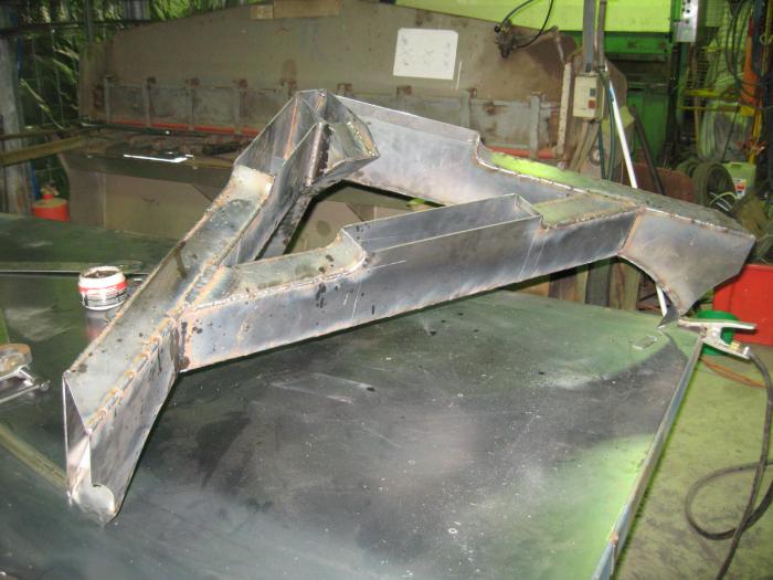

Hi all, I have started the cannon base in the carrier which is made up of individual pieces and quite a few of them at that. Unfortunately the one with the carrier is too far gone but a good template. Whan they made these,they were very precise with their construction so it is a time consuming item to make but also critical as far as measurements are concerned. If it not correct it just won,t fit. In order to make sure it will I have tacked it together first then I will fit the unit then fully weld later.

Back again, fits very well and it is now fully welded. Time to start fabrication of the cannon mount. A bit more intricate and very precise part of this resto.

Hi All, started the mechanno base for the cannon. This is just the start and it is about 8-9 hours for these parts.

Howdy all, cannon base is moving along slowly but as I said it is fairly intricate but I'm getting there. I had to bolt it together to see if it lined up. There is still heaps still to do.
