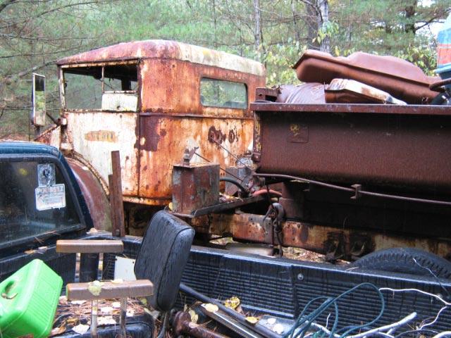

I am not certain if this helps but I recently found this Cab 13 C60L in Thorne, Quebec dated January 13, 1942 on the dataplate. The truck was a "Gas-2" petrol carrier but had last been used as a snow plow/salter combo. I thought that it was odd that the army registration number "64.914" was painted on the first coat of yellow paint. It may have last been used by the RCAF but i thought that they had a seprate numbering sytem for vehicles.
J

Here's a March 1942 Cab 13 data plate
Old 10-10-09, 04:36
Here's an earlier one.
Old 10-10-09, 05:36
Jason must have slipped that Jan 13 1942 one in when I was looking for my March plates. Here's a Nov 7 1941 Cab 12 so we have it narrowed down to within 67 days. Does anyone else have any in between?
Old 10-10-09, 05:49
After that last post I remembered these Nov 11 41 trucks so we're down to between Nov 11 1941 and Jan 13 1942.

The Infoex lists a 13 cab Ford F15a that was owned by Harry Salens with a build date of 1942/02/15 but no serial or engine number is recorded.
j
