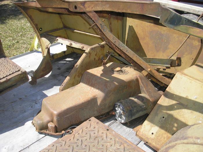

I have a CMP floor and back lower cab wall for sale or trade, floor is rock solid NO major rust, back wall is a bit caved in ......... offers ?

Is that floor section a chev or a Ford?

Good question Harry, how can one tell ?, shift holes ?
here are a few more pics .......... maybe you can tell, the floor is rock solid .

here are a few more pics I just took ......... I have not been in this hobby long enough to know but Im sure someone can tell by the cutout.
If you need more Info Harry PM me or you know my Email addy.

Default Ford I think
Not familiar with fords but it doesn't look like a chev.

..in a previous picture it shows a Ford oil pan..... floor does not look Chevy has layout/cutouts is different......

The answer to which vehicle that floor frame came off?
If you look at the pillar where the door hinges bolt on, There are 7 holes per side.
From the top,
Windscreen support bolt.
next two door HINGE bolt holes
Middle two FORD mirror mounting holes
Lower two bottom Hinge.
On the Chev cabs that I have seen pics of the Overtaking mirror is mounted onto top Hinge.
Of course they may be exceptions that I am not aware of.
