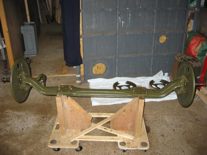

Default front axle..
the front axle was a little bit durty so after lots of work it was clean and got painted. the brake shoes where replased and everything put together again.
what a differends some paint can make. the front springs I took apart to and painted them and put them together again ready for assembly.
vooras 01.jpg   vooras 03.jpg   remtrommels vr.jpg   remtrommels vr 2.jpg   vooras 04.jpg

Default more front axle..
here are the last foto's of the front axle. so the first big thing is ready lets do another one, the rear axle ? but first
Old 17-06-09, 20:56
Excellent work, Jaap. I like the jig you made for the front axle; based on two Gamma trolleys?
Can I ask you which brand and type of primer you use?
Keep up the good work.
Old 19-06-09, 23:06
jaap de wit's Avatar
Join Date: Jun 2009
Posts: 163
he alex
I use the jig on the trolley's for the rear axle aswell, it works fine, you can roll it everywhere you want. I made it of some hardwood and cutout half a circle on the top to carry the axle.
the primer I use is the normal iron primer you can buy in every do it yourself shop (gamma) and it works fine.
cheers jaap.

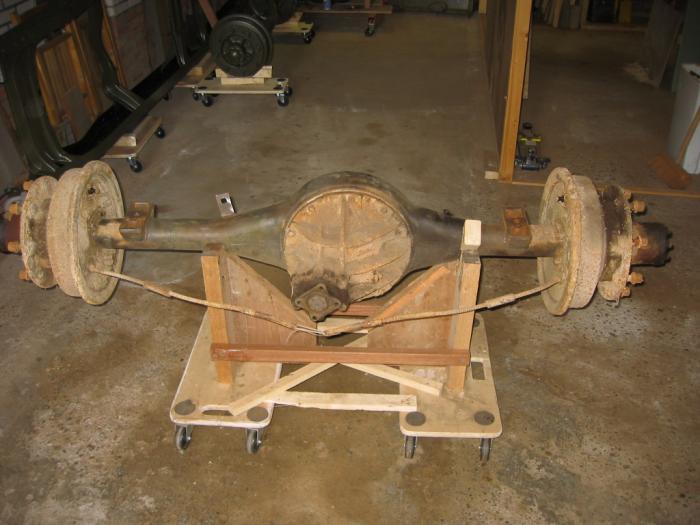

Old 29-06-09, 20:24
Join Date: Jun 2009
Posts: 163
Default so now the rear axle
on the inside of the frame I welded small bolds for bolting on the fuel and brake lines, I put the frame a side to start on the rear axle. first I cleaned the dirt of it and then took it apart step by step.

Old 30-06-09, 21:45
Join Date: Jun 2009
Posts: 163
Default more rear axle
thanks alex.
keith nice to hear from you and nel and I see you in arnhem I can't wait to go. here are some more pictures on the rear axle. the brake shoes need replacing and the oil seals, but the bearings are like new. the differential was dirty with slutch so I cleaned it out and checked the bearings and checked everything. then painted everything green. so time for a
cheers jaap
achteras 05.jpg   achteras 06.jpg   achteras 06a.jpg   achteras 07.jpg   achteras 08.jpg
Old 30-06-09, 21:58
Join Date: Jun 2009
Posts: 163
Default more rear axle..
when the brake plates were bolded on the new shoes could be placed, it look much beter now and work beter to (then the old ones).
it was only a time eating job to get the handbrake cabel and lever in place.
sometimes you need 3 hand to work with, but it is done.
I sandblasted the rear hubs and cleaned everything and put them together. hen hey where ready to put on the axle and a just the brake shoes now I can see it beter. when the rear axle is ready the rear springs can be done.
achteras 10.jpg   achteras 09.jpg   achteras 11.jpg   achteras 12.jpg   achteras 13.jpg
