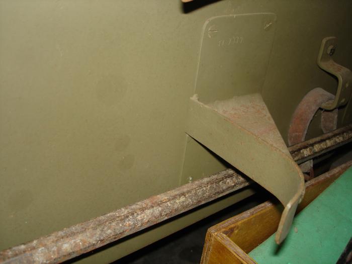

Old 17-06-09, 12:19
Default Kevin
Here's some pictures. Id go for 3 mm steel.

Old 20-06-09, 10:29
Default Kevin
I made that bkt, and its probably not that well done. The rest of the stuff on the back panel is original or pretty accurate.
I will post a pic. that might help.
Old 20-06-09, 10:48
Default Kevin
I had trouble up loading this. I had to reduce it, and now its probably not much use.

Default lynn
hi, thanks for the info, i will put mk2 brackets on for now, but if anyone has got a good picture and sizes of an original mk1 spade axe handle retainer bracket, please post the details.
I have tried reading the part numbers on your picture but there a little blurred. maybe you could e-mail it in bigger font to kevinpowles@btinternet.com.
thanks for your time lynn, i nearly bought a british mortar carrier from new zealand a couple of years back, i wonder what happened to it.
