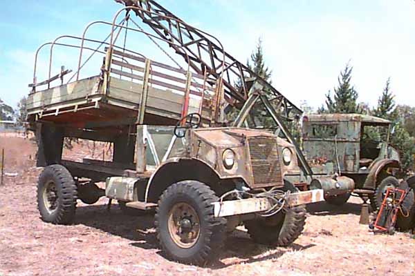

Hi Bob,
My #6 tractor had a non orginal tray fitted with 50 mm strips under but no idea what was there originally.
Graeme

Don't have immediate access to pics but I think it's worth looking to see whether the top of the cab door and crew doors line up (as they do on the No8 and 9 tractors. That may give you the clue.
Looking at a photo I have the doors do not line up and the rear #6 body sits the thickness of the sill below the crew door above the chassis. I cannot post the photos I have as they are not mine and I promised not to put them online but if you want a copy Bob on the understanding they are not to be published I'll email you a copy.
