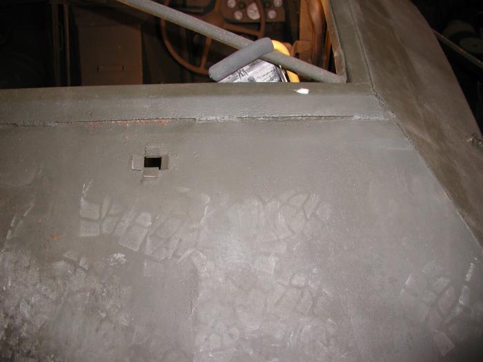

I lost my measurments for the two roof air vents, their location and the location and size of the 2 holes for canvas top straps.Just rough demensions would work.Rush please! I can't paint the body without these bits in place.
PS I made my rear doors from originals, so if they seem different its because probably more than one CGT body builder used, Gotfredfson (I think I spelled it wrong) and someone else. My samples were disassembled and copied.Would love to see pics of your doors!

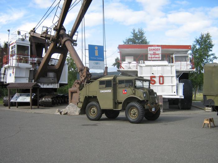

Hi , nice that there is one on the road again . on the picture is mine , the foto was taken at Beltring last Summer , Engine is rebuilt orriginal one , rest is also as it should be , no extra`s. it will do 45 MPH without over revving it.

“Toadman’s Tank Pictures” spotted Walde’s CGT on display at the 2016 MVPA National Convention in Pleasanton, California, USA.
It sure does get around.
