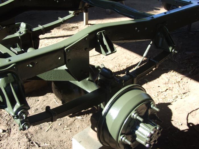

Default Looking at the chassis end,
I'm convinced you have a GS chassis. Those bent U shaped brackets welded to the chassis flange brackets are often found on GS trucks to stop the tail gate hitting the pintle hook if it is dropped.

Spending a few hours one day a week on the old girl.......about to tow it to a mates for the engine out and a good chassis sandblasting.

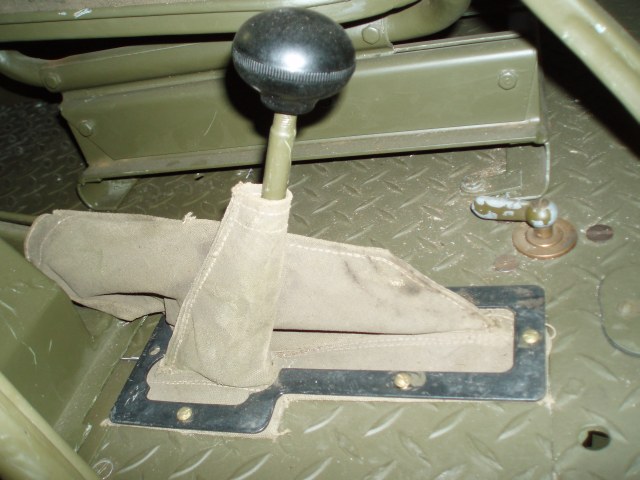

Can anyone tell me, were the gearstick etc boots made of canvas or rubber?
I'm glad I started restoration on the C8AX as the Blitz I had my eye on may be a project later when more experience is gained! (And a heap more money) ARN number was on cowl 104241.
Old 05-11-09, 11:24
C8AX Ambulance (NZ), UC1*
Join Date: Aug 2006
Posts: 388
Default Lever boots
Those I've seen were canvas. They were just remnants, so i'd like to see pics of originals if anyone has them please.

I found these ones in leather.
C8AX - I know what the C the 8 and the last letter X mean, but is the A just an indication 4x4?

Default 'a'
Originally Posted by Ausmick View Post
Rob
Yes, the 'A' was used to denote a driven front axle.

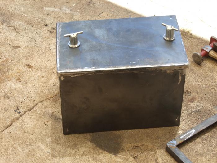

Just about got the Overflow Tank finished this weekend. The width of a tank is supposed 6¾ but I found some pipe on the scrap heap at 6½ so called that close enough. Made a dye to press out the little ‘bubble’ in the top lid. Hope to run an inlet and overflow pipe in during the week.

Default o/flow
The bubble as you call it covers the overflow pipe. the top of the tank had several holes around the pipe which went all the way thru the tank, to drain when tank FULL. fit the pipe into tank proud 1/4", drill 4 holes then cover with large welsh plug.

Got the pipes in the overflow tank weekend past and a bit of paint thrown about on a range of other parts.
