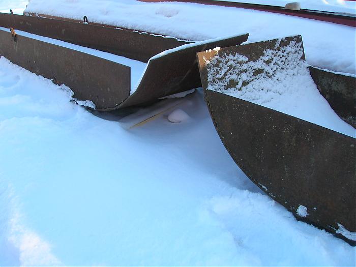

Hi again
I have now found a guy that will help me recover the UC. He owns a Bombardier snowmobil or something and dont think it will be any problem driving over the ice.
As the UC is over 4h drive and 0,5h by boat from where I work Iīd be thankfull if anyone could help me with the following:
1, How broad are each track?
2, How broad and long is the UC in total?
3, How much do you think it weight in itīs current state? (See pictures in the beginning of this post)
4, Does anyone have any drawings of an UC with measurements?
My plan is to put a U-beam under each track, the U-beam will be bent up in the front like a ski. This will hopefully give the UC a better "glide".
Thankfull for any input.

Iīm still waiting for the ice to get thick enough, itīs now around 30cm thick and I would like it to be 40cm. I have also sourced a pair of "skis" for an old loggingtrailer that hopefully will fit under the track after some adjustment. Iīll keep you guys updated when I have more info. The end of march or beginning of april will be perfect for me if itīs still cold enough.

Well I will try to recover the carrier in the end om march if everything falls into place. I have found the perfect skies behind an abandond barn and will do the nessecary adjustment to fit the carrier. See pictures.
Any input from you are appreciated. Scale is metric.

Posts: 314
I would first take a trip out to the carrier and pack a road to it with even a snow machine. It would freeze deeper. Also when I went to get it I would tow it with a long cable (15 meters.) to spread the weight out. You don't want the two vehicles too close together.
Model U.C. NO-2 MK II.*

Default recover
Erik
Soooo how's it going? Haven't heard anything in a year and was wondering if you are still trying.

Ledsel, last year in march/april my friend managed to loose the oilplug and ruined the gearbox in his Haegglund BV 206 that was going to drag the UC. Now it has a new gearbox and we will make a new try when conditions are as best. I did visit it last summer, itīs a great piece of machine in very good condition. Will post more when I have more news. Have a walkaround movie from my cellphone but donīt know how to post it.

Well, itīs still in the terrain. Hoping to get it this winter season, have been waiting for long now. Been searching for more UCīs since last time and found this. According to the owner there are some armor and engine covers somewhere lying around. A very good project with some pieces missing.
