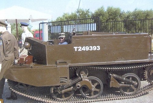

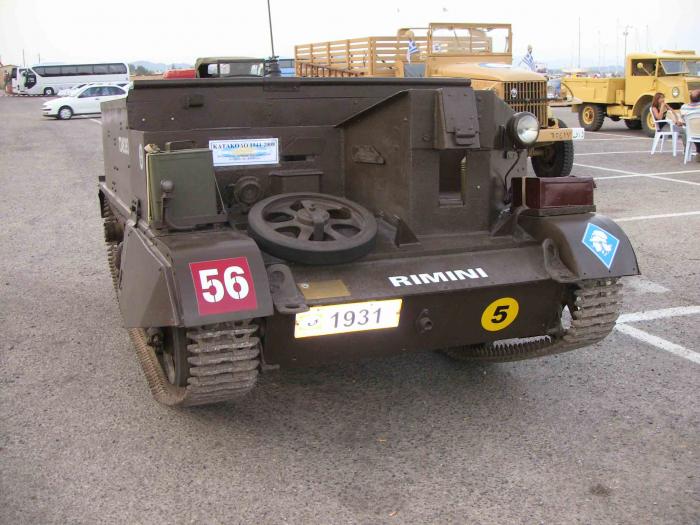

The only example of universal "Bren" carrier in Greece, is a remarcably preserved machine owned by the Korean veteran Kostandinos Faros, who gave me the numbers:
Number: T249393
Engine Ford 18633130

Old 24-01-10, 00:12
Default Kostos
The carriers in the old photo are Mk1 carriers.
Is that a kiwi on that tac sign?
Old 24-01-10, 02:19
Haridimos's Avatar
Kostas
Join Date: Jan 2010
Location: Athens, Greece.
Posts: 270
You are right. The Greek Army had the mk I, ex british machines. The photo was taken at a base camp at North Africa.
No, Lynn, the sign depicts the head of Athena... (Minerva) the sign of the greek mechanised divisions that period. Today has changed slightly
