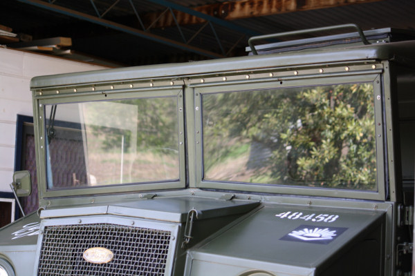

thanks for the comments guys, we finally got the glass for the windscreen the other day. The passenger side frame was worst for wear so we decided to get it done first, and had no problem at all, moved on to the nice smooth drivers frame and .... it was 99% in, then CRACK Thankfully its a small crack in one corner. Anyways a little bit of character is good for an old girl like a blitz.

Here are a couple of recent photos. The windscreen wipers now work, they just need arms. Starting work on the side curtains, we had one frame that looked original so we've copied it for the other door.
