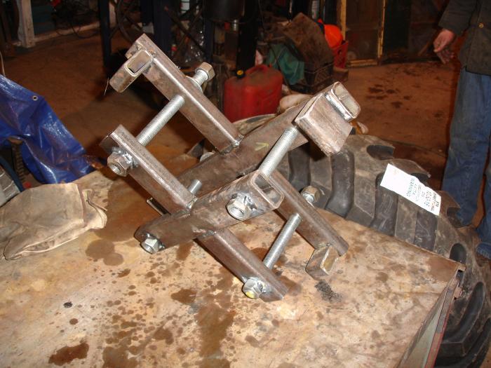

Default Tire press tool
One more shot of it under construction, three of the finished tool. We haven't yet made a second cross arm for 20" rims/tires but we can't think of any reason it shouldn't work just as well.

Default The tool in use and the finished result
Now that most of the learning curve is behind us, the next tires should be faster to process. We plan to pay attention to having two set up in each direction so that Bob can make a matching set of either "open end touches first" or "point of V touches first" or random to simulate "spare was put on and no-one cared which part touched first. If anyone is wondering what the yellow arrow on one arm signifies, it is because the arms line up more smoothly in one orientation than any other.

Default I'll have to add your new tool to my tool page
Hi Guys
Well that tool sure looks like it fits the bill given the hole size on the rims is the same I agree that it should work with either 16 or 20 inch rims. Looks like if you turn the crosses around so the bead blocks face out you then use the rig to pull the two wheel half's together.
Get out your steel marking stamps and punch a part number on along with CMP Tire Mounting Clamp or some other suitable descriptor. Just for the hell of it date it 1942 and if you can put the broad arrow on it just to screw somebodies head in 20 years.
I had used a pair of large C-clamps but I must admit to having bent one of them in the process, to much force.
Your tool also looks like it will help save the studs and nuts from being overloaded.
How about a picture of it in uses the next tire you mount. Now I see the added picture with it in use, great.
Last edited by Phil Waterman; 08-02-10 at 20:52. Reason: saw added picture, additional thought
How about a YouTube video?

Default We are holding off for a Hollywood contract....
Next tire will set up a tripod and do a step by step photo shoot....... we were to eager to make it work this time.
I don't think we move fast enough for UTube....!!!!!

Next tire will set up a tripod and do a step by step photo shoot....... we were to eager to make it work this time.I don't think we move fast enough for UTube....!!!!!Boob
Cecil B., er, Bob, I can video the procedure and edit it to make us look like we know what we are doing...we may need a few takes. Or we can time lapse it like Phil's teardown video. In any case, I really like Clive's idea.
And don't for get to at least stamp "Patent pending" on it and a number..
Looks good ..
Probably sell a few ..but who has so many CMP's that they would need one..??
But at $6 million a copy ..maybe..
