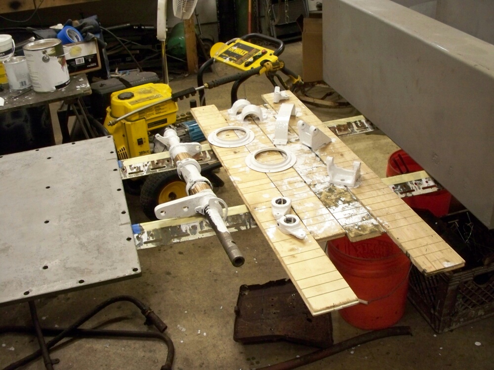

Old 15-03-10, 17:20

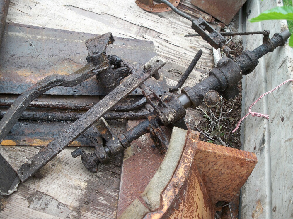

Old 20-03-10, 02:56
Join Date: Sep 2009
Location: Waterloo
Posts: 366
More pictures.
100_1070_resized.JPG   100_1069_resized.JPG   100_1361_resized.jpg   100_1368_resized.jpg   100_1376_resized.jpg

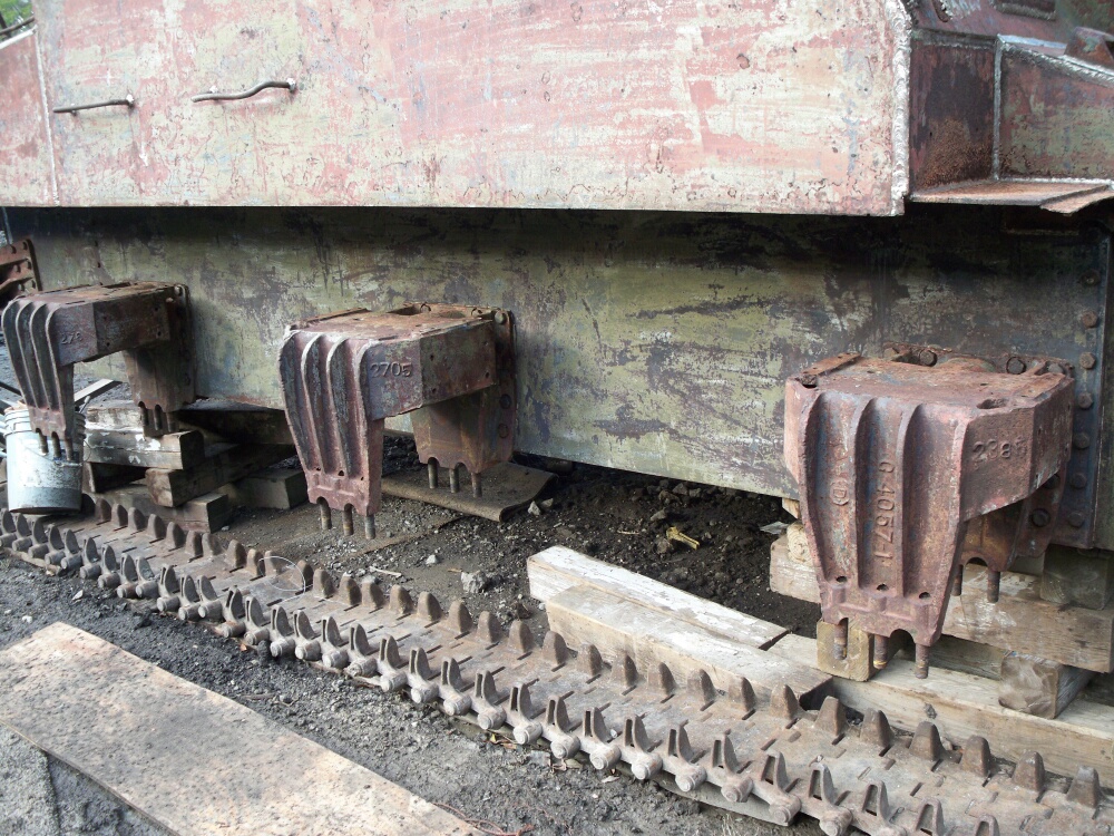

Old 21-03-10, 03:12
Join Date: Sep 2009
Location: Waterloo
Posts: 366
Pictures updated
100_1273_resized.jpg   100_1279_resized.jpg   100_1411_resized.jpg   100_1493_resized.JPG   100_1324_resized.jpg

Old 27-03-10, 03:24
Join Date: Sep 2009
Location: Waterloo
Posts: 366
Bryan; Very nice. Jesse.
100_1454_resized.JPG   100_1487_resized.JPG   100_1481_resized.JPG   100_1522_resized.JPG   100_1500_resized.JPG

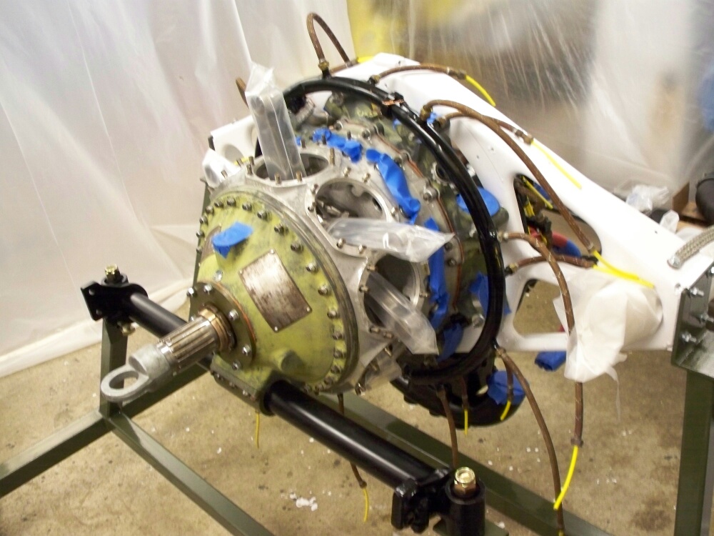

Old 27-03-10, 16:58
Join Date: Sep 2009
Location: Waterloo
Posts: 366
Just about ready for the engine. Unfortunately, the engine is not ready. We should get the remainder of the parts for the engine on Monday. Jesse.
100_0860_resized.jpg   100_1908_resized.JPG   100_1179_resized.JPG   100_1481_resized.JPG   100_1532_resized.JPG

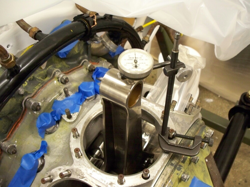

Old 05-04-10, 04:59
Join Date: Sep 2009
Location: Waterloo
Posts: 366
May be running this week. There is still one bad cylinder. It was dropped somewhere along the way, and needs to be welded. Jesse.
100_1565_resized.JPG   100_1572_resized.JPG   100_1580_resized.JPG   100_1411_resized.jpg   100_1404_resized.jpg

Old 05-04-10, 14:18
Alex McDougall
Join Date: Feb 2009
Posts: 200
Default R975-c4
The -C4 cylinders sure look different to the -EC2 and -C1's that were in many of the Lee's/Grant's.
Also back in an earlier post I see the suspension gudgeon's drop down once the caps have been removed in that style of suspension bogie - a significant improvement regarding serviceablility compared to the early US M3 Medium tank bogies.
Great work Jesse!

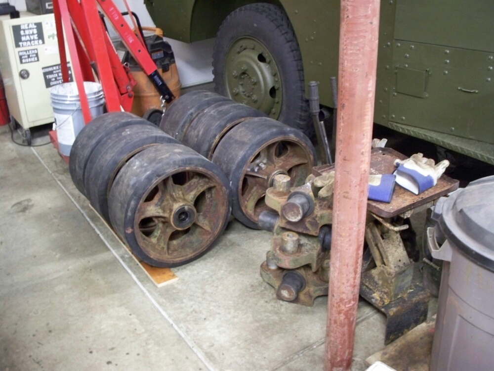

Terry,
Early in this thread is a RHS pic of Jesse's Sexton. It shows track and roadwheels off and suspension units dismantled but with the core suspension housings or stations still bolted to the hull. They appear to have been based on roughly mid-production Sherman design - or maybe they weren't. But on the underside of the stations are caps that retain the suspension arm gudgeon pins to the station housing. So these caps can be undone and levered downward off the bottom (after the volute springs have been compressed first!) presumably allowing the gudgeons still through the suspension arms to be knocked downward and out, followed by the springs and spring base. Maybe Jesse needs to verify or correct what I've written about that.
Whereas on the M3 Medium tanks instead of being capped on the underside of the station, they had a cotter bolt that ran through a fore-and-aft hole. Maybe in service there wasn't a huge difference if they were looked after but 60 years later there is considerable difficulty getting the old units apart. The whole unit has to be placed in a hydraulic press of around 100ton capacity. Maybe Jesse only had to place the suspension arms with pin in a press. I may be wrong
The Australian Army seemed to have replaced many if not all of the original suspension units with something similar to this later style, on the twin diesel M3 Mediums that they retained in service postwar.
Old 06-04-10, 04:26
Join Date: Sep 2009
Location: Waterloo
Posts: 366
Makes sense to me. I'm not familier with the early M-3. The bogies came apart easily, except for having the arm gudgeons pressed out. No electric, no air tools. 20 ton jacks, big blocks, bigger hammer, lots of elbow grease. Jesse.
100_1290_resized.jpg   100_1287_resized.jpg   100_1280_resized(1).jpg   100_1274_resized.jpg   100_1112_resized.JPG
Old 06-04-10, 11:12
tankbarrell tankbarrell is online now
Adrian Barrell
Location: Suffolk, UK
Posts: 862
The early, M3 type suspension is harder to dismantle because the gudgeon pins have to be withdrawn through the casting unlike the later M4 type which as has been said have caps retaining the pins to allow removal of the innards en masse.
The later M3 tanks had M4 type suspension and many of the Australian M3s are of this type. They were built with them though it is possible to change from one to the other, the bolt pattern being identical.
Sexton actually had it's own bogie design, seemingly the same as Sherman but with limited suspension travel presumably to limit bouncing under high angle fire. They can be identified by the ribs on the outer face getting wider towards the top of the bogie, standard sherman bogies having parallel ribs.

Old 11-04-10, 03:55
Join Date: Sep 2009
Location: Waterloo
Posts: 366
Firing it up Monday morning.
100_1586_resized.JPG   100_1596_resized.JPG   100_1584_resized.JPG   100_1600_resized.JPG   100_1599_resized.JPG

Old 12-04-10, 01:32
Location: Ottawa ,Canada
Posts: 2,916
Default Starting proceedure
http://www.youtube.com/watch?v=EkcX0KGIBwk
Jesse..
Make sure you crank it over at least 20-30 revolutions by hand to clear the oil from the cylinders(Or you may break a rod or at least bend a push rod and wreck some valves and pistons..)..it will be in the lowest level cylinders that the oil collects..and migrates to.. and make sure the engine oil is pre heated before attempting to fire..
Good luck..

Old 12-04-10, 02:52
Join Date: Sep 2009
Location: Waterloo
Posts: 366
Ready to rumble;

Old 12-04-10, 12:34
Posts: 2,916
Default Right nice..!!
Jesse..That is beautiful...
I'm heading north this morning and will have the windows open from Fort Wayne on..If the wind is from the west I should be able to hear that beauty running..No time to visit this trip but would love to stop in next trip July..may have that radial info by then..
Strap a strip heater to that oil tank and pre heat your oil before starting...
Beautiful control panel..you obviously know something about radial engines with the right starter and mag switches..
Can't wait for the you tube feature presentation....
The Scintilla and Bendix mags are timed different...Although Bendix bought out Scintilla in 1929 they made many different magnetos..The Scintilla is different from any other type...Scintilla Magneto
This magneto is different than other magnetos. It
has a rotating magnet instead of a rotating coil.
You can do the Scintilla Shuffle or have your helper do it..Here is how....
Doing the Scintilla Shuffle, take a good Scintilla magneto, hold
one of the high tension leads in one hand and with the other hand quickly spin the rotor. The
dance or shuffle created by the high voltage will tell you in general terms that the magneto is
working, and the dance it created is called the Scintilla Shuffle. Caution: do not try this at home
if your nerves are frayed or if you are subject to seizures, heart trouble or diarrhea.

Old 13-04-10, 03:07
Join Date: Sep 2009
Location: Waterloo
Posts: 366
Didn't happen today. Magneto wiring trouble. It has been corrected, and another attempt will be made tomorrow. Jesse.

Old 14-04-10, 04:34
Join Date: Sep 2009
Location: Waterloo
Posts: 366
Oil pressure problems today. Had to pull the oil pump to correct the problem. We will try again tomorrow.

Old 14-04-10, 18:35
Join Date: Sep 2009
Location: Waterloo
Posts: 366
It started right up today. Runs great. The video is actually the 4th or 5th start. To many things to do than take pictures. Jesse.
http://www.youtube.com/watch?v=QTNiTY6jLVA
