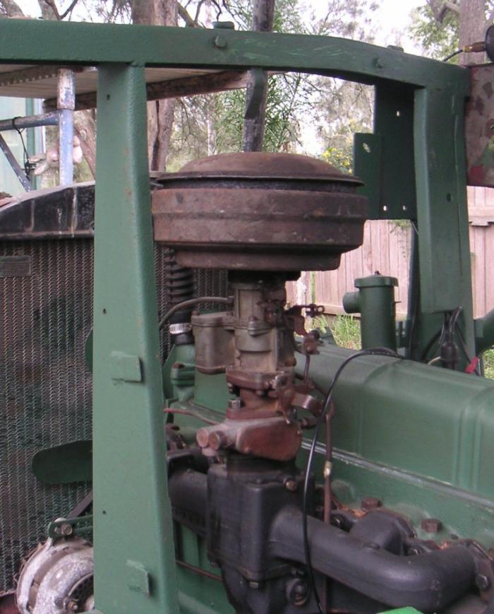

Hi All ,
another small problem on my C15A , cab 13 ,
The air filter on the carb seems to be a bit large
and is fouling on the left upright of the cabin ,
the diameter of the airfilter is 9" and it seems like it could do with 1/2" or so clearance to allow for vibration .
Could this be from a different model ?
Thanks Jim

Hi,
The one i ave on my chevy is not that one
is smaller and higher

Thanks Bob , if you can measure the OD of your I will know what to look for , might make up some thing till then ,seems like mine is off an early model . Jim

So I found an old one I had repainted.... and took some photos and measurements.... it is exactly 8 inches wide...... so here is your extra clearance.... and when sitting on the table it is 5 3/4 inches high.
Throat size is the same on the original W 1 216 carb as on the early 261 carburator....... 2 5/16.

Looking at Bobs photo there are some differences from the one on my `45 HUP and `42 Pat 13 C60S. I believe that these two had their original air cleaners. primary difference is that both of mine attach to the Carb via a center bolt down into the carb.
Now my `41 Pat 12 C60L the air cleaner body attached to carb via the clamp as shown in Bobs photo.
I'll take some photos and measurements and post them.
Attached photos are of the original air cleaner from the `42 Pat 13 C60S. It is 8 3/4in Diameter Top 7 in Diameter Bottom and fits a carb throat of 2 5/16 OD.

I believe ALL W 1 carbs had a clamp style air breather like your cab 12...... I have never seen a W 1 carb with a center bolt....... now later Rochester carbs came with or without the centre long stem bolt...... most of the late 50 to early 60s Rochester where like that..... so maybe some one changed the air filter to match the after market carb.......

Early January 1941 shows only one model avaialble (cab11/12) 1525983.....
9" x 5 7/16
.late replaced by 1526795...listed in 1045 parts book.....same size as above...
....later replaced by 1543682..1 quart 8 3/4 x 6 11/32
....and of course two different type of Carter W 1 carbs.....
first type W -1 518S and 518SA
...second type.... called the "Dustproof Carb" W - 1 589S
Neither carbs are shown with a central long bolt that would hold the air filter.

Yup they kept making them better below are photos of W-1 with Dust Proof Top and Center bolt air cleaner hold down. My `45 HUP has one of these which I suspect is the original, little on that truck was changed. My `42 Pat 13 C60S also had one of these which is shown in picture, which might be a replacement.
In the picture with the other carbs you will note the rubber boot around the accelerator pump link, you will also note that it is no longer sealed to the top of the carb, unfortunately it didn't like the alcohol in the gas. The other two carbs are for a 261 and a 235/
I suspect that they went to the center bolt because it is a more secure way of holding the air cleaner on. Willing to bet that a lot of the clamp version were put back on and the clamps not tighten resulting in the air cleaners falling off spilling oil all over the manifold.

Thanks for all the info , I have found one that fits fine , it is 8" OD , 5-1/2" tall , the thread on the center pin is 3/16 unf whereas the 9" OD filter has a 1/4 " unc thread .
