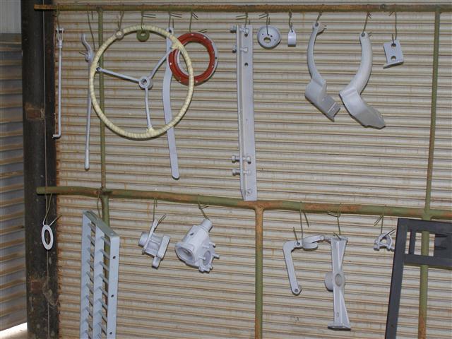

More priming and painting
P1200673 (Small).JPG   P1200674 (Small).JPG   P4230306 (Small).JPG   P4230308 (Small).JPG   P5080357 (Small).JPG

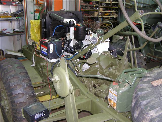

I had time to call in again today and real progress has been made
Ross the front shaft has been reversed

I have just read this thread, as I have a Dodge. The crankshaft is not the correct crankshaft. It only has four bolts to hold the flywheel on, and should have eight. The eight bolt crank is the T214/ T223 truck crank, with the counterweights to suit the sustained high revs. the four bolt crank is a car crank, and may not even be the right stroke.To perform well the truck needs the right crank.
Sorry to be the bearer of bad news, at this late stage.

Hi Lynn,Thank you for your interest. we found out early on that the engine is a 1938 car one so for now Kevin has just sourced parts like the govened carby etc. to make it as authentic looking as possible.

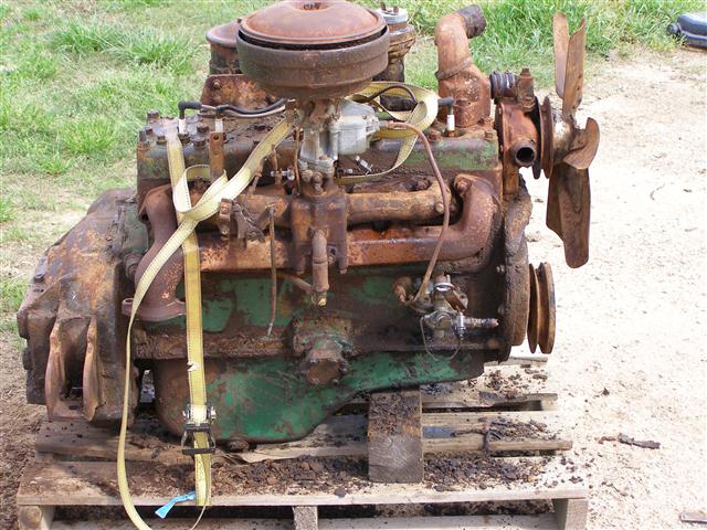

The engine is back out the block is warped and the head won't seal
Another engine has been bought and the work begins again

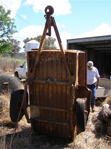

The trailer was recovered today, Kevin is the proud new owner
boy the trailer was heavy to lift over it's end to drop it onto the trailer.

Can you elaborate on the "block is warped"...... was it just the head/deck surface area or the whole block.....? you had problem whenyou first installed the crankshaft..... binding when bearing thightened...... was the block line bored when at the machine shop..?
What size engine are you working on...... 230 cubic inches...? or the 251..?
The ideal engine for you would be a donor from the Dodge M 37..... usually a 230 in US models.

Your new motor looks outwardly correct.(Ball and Ball carb on early T214) Engine number should be T214. a T223 (6x6) or a T215 (1/2 ton) are good options. Just make sure you use a crank with 8 bolt holes to locate the flywheel.

Yes Lynn the new engine starts with T214.
Bob the block was line bored the bearing bind was caused by the machiene shop not grinding to the bearing size they were told to.The warp was on the top of the block and was only evident when a straight edge and fealer gauges were used. As far as I know the engine is 230 cu inch.
