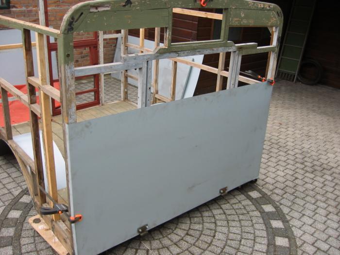

I started on the back wall part. I had to drill some pointwelds out to get to the rust behind the sheetmetal and then weld it up again. I sealed the seams so the water can't get in again. when I placed the wall on the car I learned that you have to wait with bolting it down to the floor untill you have the roof in place, otherwise the roof will not fit to the front window (about 1 1/2 inch sort). it took me only some 20 bolts to lossen and afther to fasten again.
but first, I sand blasted the roof in my home made blasting cabin. there where two bad spots on the back wall and some holls to repair.
see the pictures in my next reply.
cheers jaap

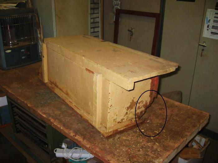

hi guy's now the truck is as good as ready, only some small things to do I started on the radiobody whitch need a lot of work. the body is as you can see the wood frame only and some bits like the vent duct's, de door, the inside fenders, ect. I started with the under side I cleaned it and put the brackets on the right place for my truck frame. then I put some foom inplace as insulation and covered it with playwood and painted it with tectielpaint.
as this needs to dry I took the door apart by removeing all the old ironsheet and the windowframe whitch all needs replacing. the wood around the doorlock needed some replacing to it was broken on the point were the lock is placed. so up to the wood work now.
cheers jaap

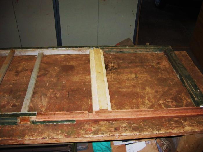

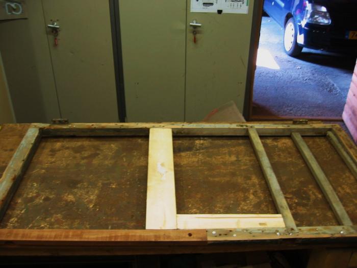

Back on the door of the radiobody. the part of the lock was gone and I had to make some new parts. I made the part for the lock bigger so it wouldend brake again. I checked if the door was square by placing it in the door opening of the radiobody.
after this I made strips of iron sheet and screwed them on the door outer sides just far over the side so the door would still close. these strips act as supports for the ironsheet that covers the outside of the door, it get's folded around these strips. see you guy's next time when I do the outside of the door.
cheers jaap

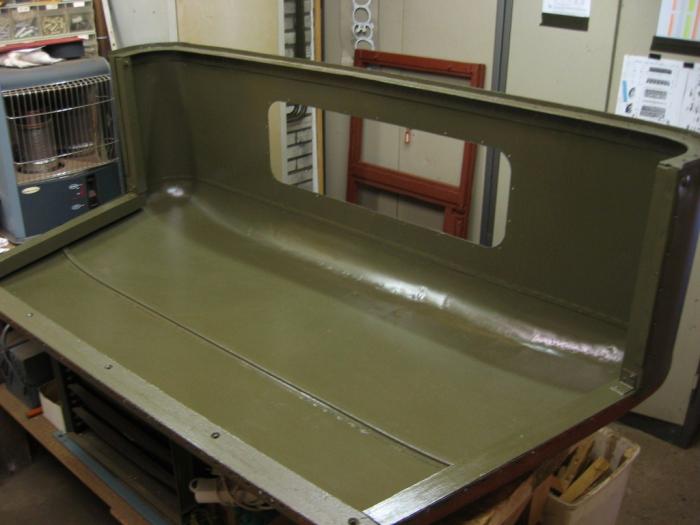

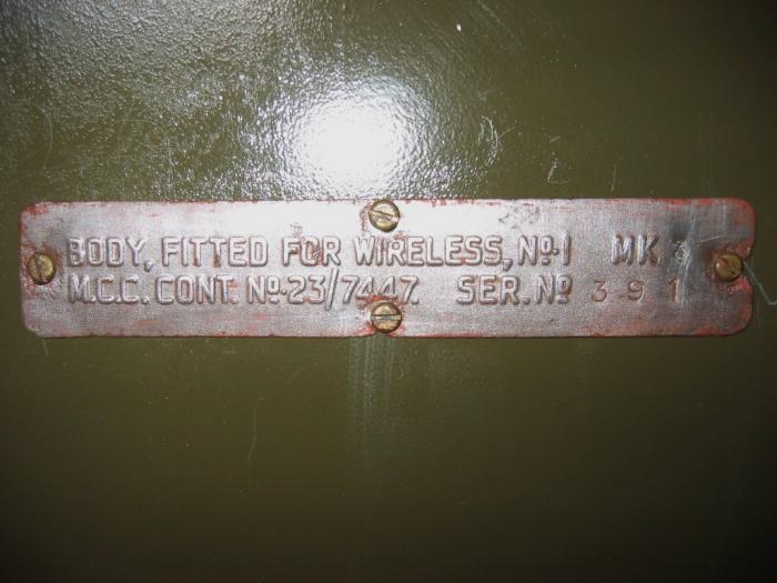

hi guy's the radiobody starts to get in shape don't you think.
now all the sheet metal panels are on the truck I had to make a raincap above the door.
then I thought it was time for some painting, allway's nice to do this.
first the roof was painted black twice. then the sides go green and whalla it looks a hundred backs. the windows come in later because I have to make the frames myself so I do this after I have the registration on the truck.
I cleaned the date plate for the body and attached it.
(body, fitted for wireless, No.1, mk 3 m.c.c. cont. No.23/7447 ser. No 391)
look's good dos it. now the only thing to do to make the body water tide is the small window above the cab. sorry this comes next time.
cheers jaap
