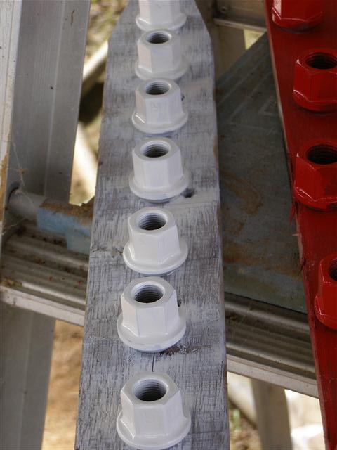

One corner of the blitz finished. As I'm putting the tyres back on I am using new rust bands and the valve stem is sitting much better than before.
I think I will do the other three wheels together to save on cleen up, but first I have to dry another 40 gallons of sand for the cleanup.

lovely work Robert keep it up. Another book will be on it's way to you soon as well. Bit tatty but worth reading.

Wheels should now last another 65 years.
From my experience installing tires on sand blasted clean and freshly painted wheels is a lot easier than a rusted pitted hulk.
Keep it up.

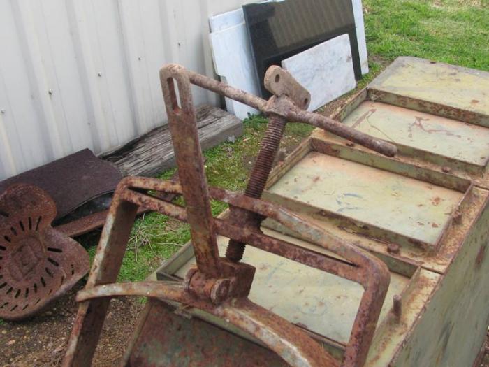

Actually Mike, there is only a little rust in the body and it is pretty straight. Only the top corners of the tailgate are in need of replacement. There are a few bullet holes in the front panel, but as Bob says, that adds character.
Robert needs some hoodbows and the mounts which bolt to the side of the body if anyone has any.
The toolbox just needs a sand down and a coat of paint.
The spare wheel carrier is in need of a small weld job, but, it has an unusual antitheft devise on it. I'll post some photos later.

Here's the photos of the antitheft devise and more.
RobsTray 002b.jpg   RobsTray 003b.jpg   RobsTray 001b.jpg   RobsTray 010b.JPG   RobsTray 013b.jpg
