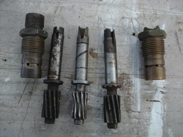

Old 01-11-10, 02:00
Default Brian
They are refering to the other (gearbox) end. I will post component pictures in the next 48 hrs.

Old 02-11-10, 12:18
Heres the pics. Dirk your housing is interesting. It appears to have a seal in it. I havent seen one like that. My one has a "W" cast in it. Is that Windsor?
The speedo drive bits have all the faults.

Hi Lynn and Richard,
You were both looking at the correct parts. I tried to find a picture of these parts in both workshop manual and Mk1* parts catalogue but there is absolutely nothing in either book. Then I looked in the later parts catalogue for Mk1* AND MkII*. This uses the same plate as the Mk1* parts catalogue but with the two items I need added! It shows the gear CTL2216 and housing CTL 2510 B2. So Richard, you were right there. !! Lynn's left picture says it all, they probably fail often...
Lynn or Richard, if nobody has NOS or used good parts for me can I borrow one of each part from either of you to have them made? I will off course return them after reproducing them.
BTW, Lynn the seal is also shown. Part number C01UC105387

Old 05-11-10, 14:40
Dirk Leegwater (RIP)'s Avatar
Dirk Leegwater (RIP) Dirk Leegwater (RIP) is offline
Dutch member
Location: Broek op Langedijk, Holland
Posts: 518
That's right Lynn, the Loyd Carrier have used the same gearbox
coupling, including the hard to find parts: Spindel & Coupling Gear.
Dirk
