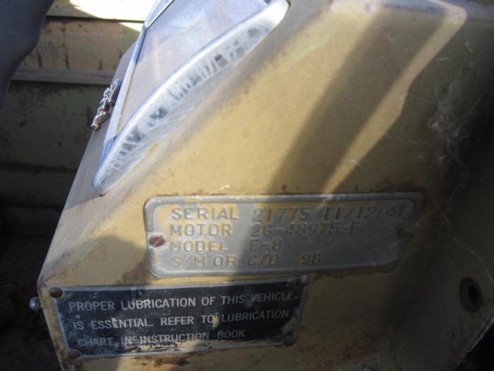

good to see a 800 cwt going to a good Canadian MLU home. I tried my darnest to talk Ernie out of those bloody 13 inch rims, but good on him he stuck to his guns and they stayed with your truck. Get yer done! Cheers Rob
If you don't mind Anthony I will add a clearer shot of your data plate for people here keeping track of the registry.

Default F8 numbers
Hi Anthony
My F8 is serial 21435 (340 behind yours) and my engine number is 45176 (799 behind yours). My date is 11/7/41 which I assume is 7th Nov 41 only a few days behind yours. Wonder if the serial numbers were in sequence for all Ford CMP's not just the F8's in which case 340 in five days might be reasonable.
Interesting that yours has the FFW speaker tube cut-out in the cab and mine doesnt. So did they make this cab mod for the FFW only?
My truck is also C/D 98.
Kingston

Default More on F8
Anthony
Now that I see your pictures, your truck does not have the FFW speaker tube cut out. I was puzzled if it did have because there was less reason for one with the long box which yours would have had ( along with TWO fuel side tanks) than with the short box FFW which had a long gap between the cab and the rear box. Not sure if the rear window insert is original or not - mine doesn't have it.
I see that someone moved your door handles down quite a bit!

this will give me one less thing to worry about while I do the chassis and cab work.
