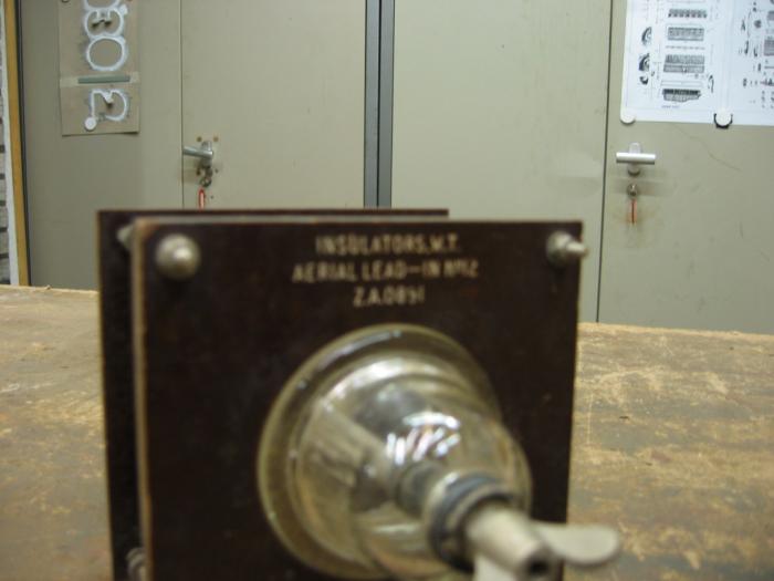

I bought a wireless insulator outlet No 12 for the "A" aerial for my radiobody.
it is buildup of a 2 piece hard material and 2 glass cups with a treaded bar for the attachment of the wires and long bolds to attach it trough the wall of the body. it was put in place and on the outside sealed with kitt.

hi guy's after all that wood work I had to do something else so I got to a radio fair her in holland and found the tube part of the "B" antenna mount for the 19 set.
I have the rubber part already so I only have to murge these two together and whalla... just like old.
I made a bracket for it and mounted it on the radiobody on the right fronttop.
now I did some outside work again it is time to go on with the inside because it is far from ready, but I am getting there, some day
cheers for now
jaap
