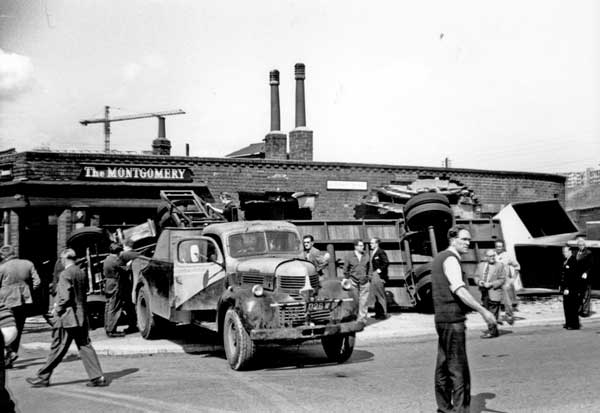

I have saved these three pics of XWD Dodge's with dual rears over the years, I would credit source but I can't remember where , always assumed they were conversions but maybe not . Except for first pic they have flotation tyres front and duals on rear so possibly these two are conversions ?

Old 26-01-11, 16:25
gordon's Avatar
gordon gordon is offline
Location: Central Scotland
Posts: 708
Default Mixture
There was a specific chassis / axle / transmission / wheel combination for the T110L as a dual rear, something like T110L-D with a numeral in there too. I can never remember if the dual rear trucks came with the two-speed rear axle - I think they did.
Undoubtedly some of those pics are original dual rears, and some are ordinary T110L trucks with adapted rears - can't tell from photos.

Old 26-01-11, 18:17
chalky's Avatar
chalky chalky is offline
Location: North Yorkshire
Posts: 78
Perhaps the first one is a genuine London tipper as the body is very similar to those fitted to wartime Fordson 7V'S

My info has it that the T-110L-S and T-110L-13 [D-60S/DD] had dual rears. I assume that the T-110L-12 with 160" w.b. [D-60L/DD] also had duals.

Posts: 78
The first pic does look like a pukka Dodge tipper ,wheelbase and wheels.
Did some digging and picture was Norwich in 1965 and came from here , but still can't read reg. no.-
http://norlink.norfolk.gov.uk/02_Cat...&displayType=2
and on same website in Norwich garage a very clear pic of GXF332 but its a Fordson 7V !

Old 27-01-11, 11:23
serge serge is offline
Join Date: Oct 2006
Location: Bures sur Yvette FRANCE (near Paris)
Posts: 187
Default Different kind of T110
Hello GORDON
In our garage in FRANCE (MVCG PARIS) we have had the 3 kinds of DODGE T110
T110 D60 L5 long wheel base, dual speed at the rear axle and single wheel at the front and the rear. In this case the hub owns 8 nuts. (british wheel)
T110 D60 L9 long wheel base, single speed at the rear axle and dual wheels at the rear axle
T110 D60 L12 long wheel base, dual speed at the rear axle and dual wheels at the rear axle
In the two last cases hub owns 5 nut
T110 L14 long wheel base single speed at the rear axle and dual wheels at the rear axle but it's saying that there were for civilian use
