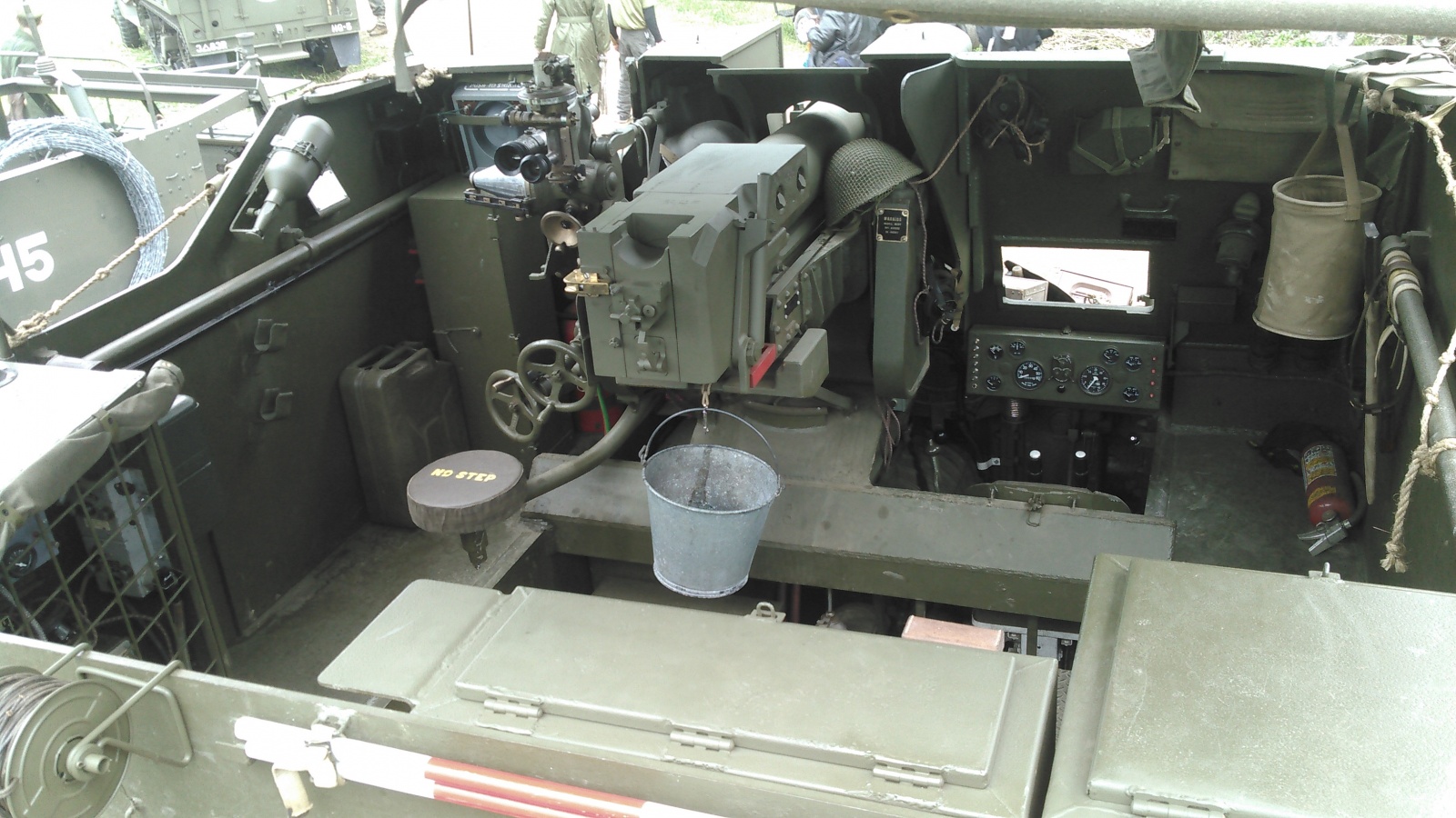

Event in May of 2016 near Elkhart Indiana.

Looks like someone has been spending quality time with their Sexton! Great Job! Looks Nice! Did you acquire a live 25 pounder or is that a replica breach ring?

The breech ring was my winter project.

Jesse,
We had similar winter projects. I hope to have mine installed in the next couple of weeks.
Allen

Cool! Looks great! Are you using original parts? Mine is plate steel with 150 pounds of lead poured in it. The propane, oxygen fittings are hidden inside.

The breach ring itself is made out of 2 inch thick plate steel that was welded together and then the outside contours were machined using a 3 axis computer driven mill as well as a standard mill. The block weighed in excess of 200 pounds before it was milled, but we did not weight it afterwards. Like yours the hardware for the propane cannon is hidden inside. The breach opening handle and the buffer are original pieces. I was fortunate that when I received my Sexton from SECO it had the original barrel that had been cut and also one complete set of breach ring parts and about 2/3rds of a second set along with two breach blocks. They were all neatly tucked inside the radio compartment.
