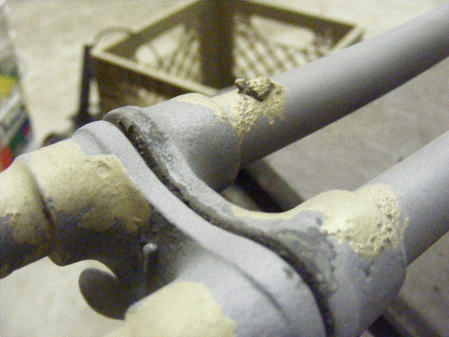

Got the frame into the sandblaster. It was a tight fit, but once in there the frame could be moved and even rolled over by hinging open and closed the smaller half. In the third photo, you can see some of the sloppy brazing from the factory. Unfortunately, it will end up looking like a large dried paint run once painted over, but thats the way BSA made her, so thats the way she'll stay.

During the blasting, another crack showed up on the frame from ice. This made a total of four of them. Since the tubes are tapered, it would appear they were made from rolled metal, with a seam, which was very subject to opening up. Below is a shot of the crack, welding it up, and the finished repair. Then it was back into the sandblaster to finish the stripping.

Finally, I get to see some results. The blasted frame is set on a stand and given an initial coat of black, followed by a tack coat of olive green.
