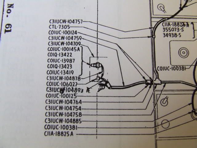

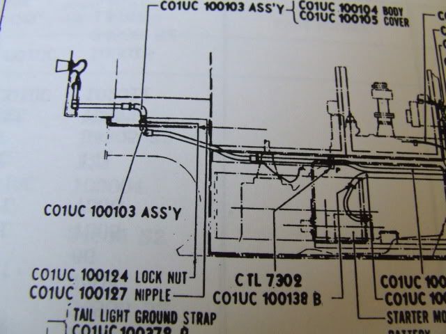

jordan do you reckon that fitting on the end is original ? it kinda looks household but having never seen one i cant say yey or ney ?
here is the images from the parts catalogue pages 352 and 353

Your last picture you posted shows this part. The part # ends with a "B" so there was probably more then one kind of light socket. This picture looks more like the CMP rear diff light. But again that would make sense as the CMP trucks moved away from the rubber housing to metal housings for the tail lights.
As for the light socekt. Yes it looks original. The socket is the same style as my original tail lamp.

Hi, From the pictures richard has supplied, CO1UC 100145 BODY CONVOY LAMP. Here are some. So this is what the canadian lens end cover looks like.
