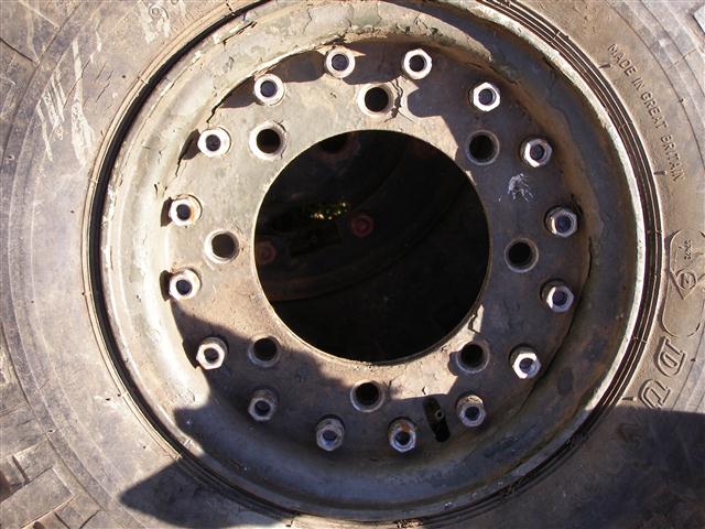

Kevin has some rims he would like identified.

I still havent got a positive ID on the above rim, 8 wheel studs and 16 bolts to hold the rim together. Thank you.
Hi Robert,
Is the tyre a 900-16 runflat, marked RF ? Looks like it could be a Ferret wheel if so.
Old 08-05-11, 19:55
Hi Robert,
could be a Ferret wheel .
Boy you breed Ferrets large down there Robert if they need wheels that size to get around Oh by the way how does something that big get down the rabbit hole?
Old 08-05-11, 21:41
Cliff,
You obviously have not seen the size of the rabbits up Richard's way

Hi Robert are those rims 16" or 18"?

I was wondering that to Graeme. I thought if they were 18's, then that rim may be off a "lend lease" Ford.
Apparently they had a split rim (refered to as a 'Desert rim') that was much heavier in design, of similar robustness to a 16" or 20" Blitz rim.

Hi Graeme and Tony the rims are 16" Kevin was trying to get a tire off one to put on the dodge he ended up using a spare for his toyota. The next time I go past we will see if my bead breaker will move the rim.
Kevin has 5 rims and they are on the market I'll get photos on Friday. Ross told him the British tyres would be too loose on the dodge rims.

If as I suspect, they are Ferret wheels, then there should be a runflat bead spacer fitted, which will mean you will not be able to push the beads away from the rim very easily. We used to have a large machine with a rising platform that centred on the hole in the rim and three or four arms which you could control to push down on the bead, then slip under the rim forcing it up away from the tyre. Are the rims alloy?

Looks like a ferret rim to me .. be carefull as the light alloy rim metal tends to bend easily if you exert too much force during tyre removal

Richard you were right they are RF I took photos today.
Mike I will tell Kevin to be careful with the rims when I next see him.
