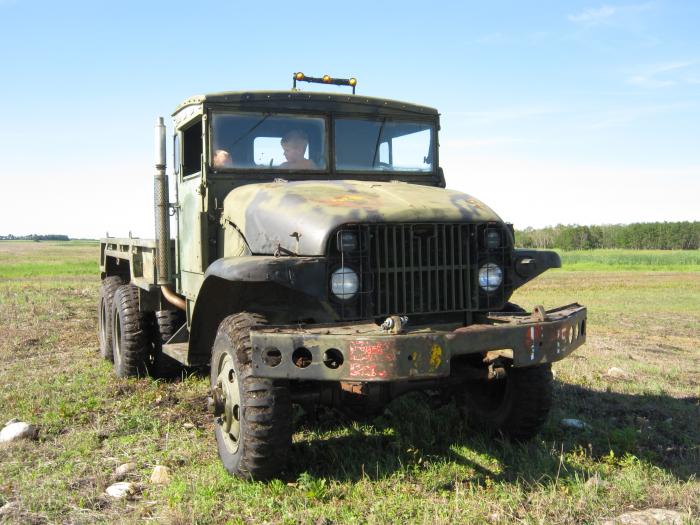

Well after a month or so of spare time fixing and rebuilding this is where im at
a running, driving ,shifting, braking ,quiet m211.
repair list
-rebuild cyd head , 2 seized valves
-hone one cylinder, moisture seized piston
-rebuild carb
-change atf , engine filter and oil,
-clean mice out of air filter and muffler ---blew out my ex gaskets
-build muffler and stack pipe
-swather fuel tank and new in line fuel pump and filter
-rebuild master cyl, and clean up booster, bleed brakes
-clean up horn button , lube up wipers-- work great now !
I was very happy the tranny worked great after getting her to run ,seems to shift in the right spots up and down. the rebuild tag on the tranny says "modified" so im guessing its got some upgrades .
now for some sand blasting and paint stay tuned,, its been a steep learning curve ,,,love it .
