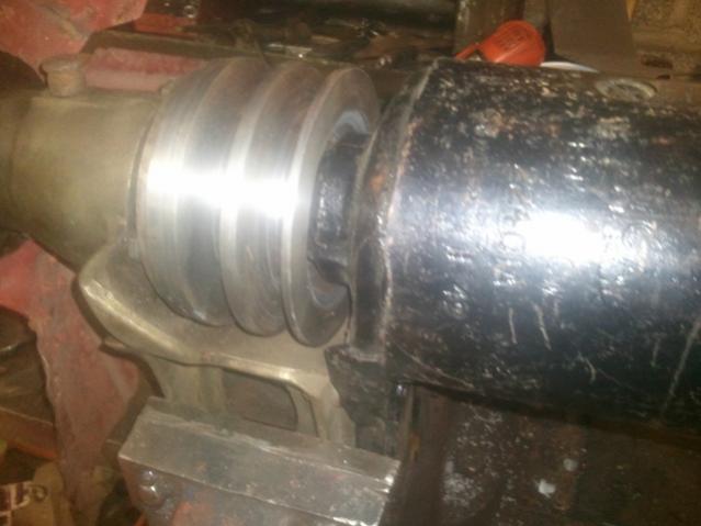

Can you tell us a bit about you fan extention? It looks a bit different.

Lynn, I had a fan extention but some one had robbed the pulley from it in the distant past. I borrowed a pattern from Kevin and turned one up. I turnned the rubber drive insert out of a nylon bush.

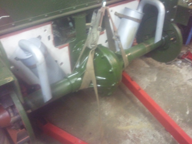

Universal carrier MK 1*1943 Ronson (under restoration)

Ferret MK 1/1 1956

Now the back axle has been stripped , repaired and assembled. The Pinion bearings were in a very poor state so they have been replaced, the diff had a wash and inspection and its not in a bad shape. Managed to get the bearings next day so now its all back together and fitted. i had to get the gear box adaptor plate made ( i have one somewhere in a safe place along with the splinned conector but do you think i can find it !!! Bl**dy disapearing carrier parts ! ) Managed to get a new one from Dirk (very good speedy service). - then new brake linings, new hub bearings and seals and all of a sudden the axle is fitted --See photos.
Photo3185web.jpg   Photo3182web.jpg   Photo3200web.jpg   Photo3205web.jpg   Photo3210web.jpg

its looking superb Shaun, amazing transformation. But please can you clean the lens on your camera
  #201
Old 27-11-11, 12:09
shaun shaun is offline
Join Date: Feb 2009
Location: uk
Posts: 528
Ta Andrew, i wish i could clean the lens, its my phone camera and im waiting for the upgrade - its scratched to bug**ry as you can see.

Posts: 708
Default I'm hoping ....
... for a 21st December picture to show how it has improved in a year.
Don't suppose it'll be driving by then?
