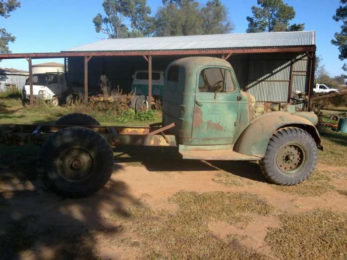

I suppose clues dont come much bigger than this. Driving down to Sth Aust for a 40th, on the weekend prior to Corowa. I was stunned to see this parked on the side of the road.

Exactly the same Chevy, as the one Ive been working on in this thread!!! Restorer assures me that the body is exactly what was on it during the war. He referred to it as a Type 'M'.
Same heavy axle and same brake drum set up. 18 inch wheels and the same flared guards.
