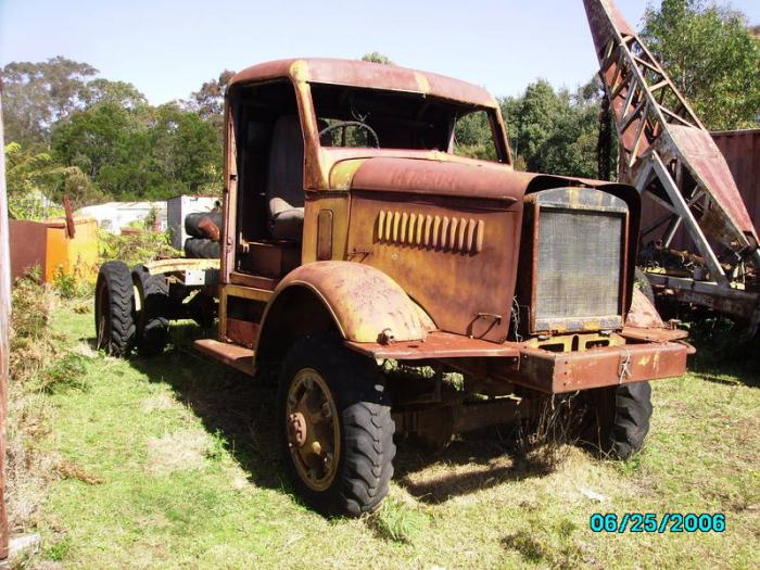

Pass this truck a couple of times a year up in the hills, no idea what it is. Has fold out wind screen, RH drive, Waukesha engine, 4x4. I'm sure this was also "running when last used" as they say in the adverts... That would be the dash board sitting on the bumper.
Could be post war, but maybe not.
FWD?
Any ideas?
Rich.

FWD HAR-1 with hard-top cab.
These trucks (originally RHD) came to Aust as part of the Canadian Radar Train to tow the Radar Van as used as the Corowa HQ!!

Certainly FWD, the axles are very distinctive. I have no idea what model. I thought HAR1 had bolt on wheels.
What a shame it is so far gone.

Quick and accurate ID, I thank you gentlemen.
It has been in this state for quite a few years, does not seem to be losing any more pieces than when I first saw it.
Shame it is as it is, but on the other hand, it is always nice to see it still there as I go past.
Maybe one of the moderators could tack it on to the discussion as linked by Tony?
