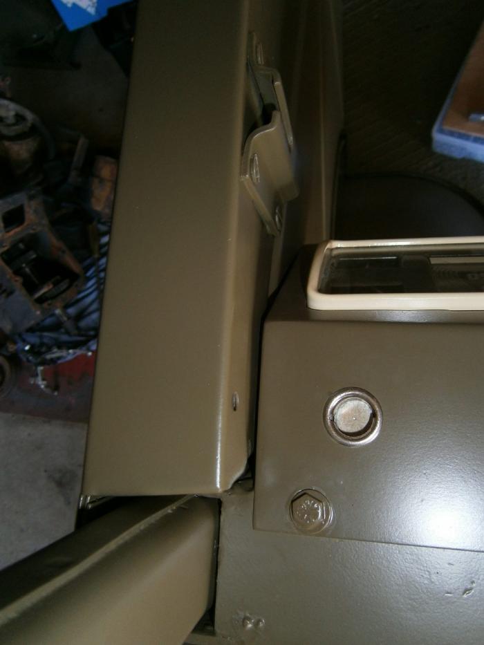

When I did a trial fit of drivers door this afternoon, I discovered that it touched the windscreen support upright. This contact starts when about 30-40cms away from door closed position. This despite the hinges NOT being tightened fully against the cab. This will definately require some effort to correct, and a thick shim (roughly 3mm) will be manufactured to keep the windscreen frame upright post away from the door. I will bolt in the window assembly to check it still fits too!
I reattached cab rear panel and tightened into position before attempting door hanging and discovered that it is leaning slightly forward, bringing it to contact rear of the door. This will be easy to fix, and i'll add it to the list of things to do tomorrow.
To do list for tomorrow:
  • Remove nose panel for better access to door hinge bolts
  • Buy slightly longer bolts, to allow for shim thickness
  • Make shims x2
  • Make alteration to rear panel so door closes
And I discovered that the modern bolt version of hinge to door are ever so slightly thicker heads, so they will need to be removed and shaved to original specs, or this too will cause contact against cab frame.
If these vehicles were intended to be thrown together by unqualified laborers then I don't understand why they didn't make far greater tolerences in panel fit. It wouldn't take any more effort in design stage and might have made the workers life easier. Now I know they didn't give the proverbial about such things, but jeezus, think of us poor restorers would ya!

Shim the door for better clearance. Two shims top, and one at bottom. Yes, I know they look a bit rough in places, but you don't see those parts. Heres a little wrinkle, when I made the second & third ones, I shaped the cut-outs sloping slightly downwards. That way they sit in place nicely, without moving around.
Name:	door dash gap.jpg
That was the only way I could get a decent clearance between the door and dash panel. At one point it touched strongly. I was not always able to actually see the touching point, so I would slip a piece of paper down there, and when it moved freely I knew it was clear. Now it's well clear, thanks to the second shim in top hinge and moving the dash itself as far away as I could.

Here is the finished product with the door. It's still not perfect but it will do.

The only thing I have yet to do is an adjustment of door lock, which sticks in the door when fully retracted. I know what the problem is and how to fix it but ran out of daylight. There is no permanent power to the workshop, yet.

Re Packing to Windscreen support frame ends.
I found the single packing I used on each end of the windscreen support frame totally eliminated the possibility of touching door, with the most desired side-efffect of bringing the individual window frame opening to within 1mm out of square! This is the case with my truck, but I would expect the tolerences to be greatly variable between vehicles. My window on drivers side will have an even 5mm (roughly 3/16) clearance on both sides with the pack insitu. Eack piece is a 50mm x 3mm flat bar, once again aluminium, making it easy to shape as needed. You would notice two of the corners are cut at 45%, this is because the taper of cab frame was just a 'bees dick' narrower than the aluminium strip at the very top. When the whole thing is assembled, the aluminium should not be visible in any way. Regardless, I painted the edges prior to finall permanent assembly.
Hope this helps.
I will discover what the passenger side has in store for me this weekend.
