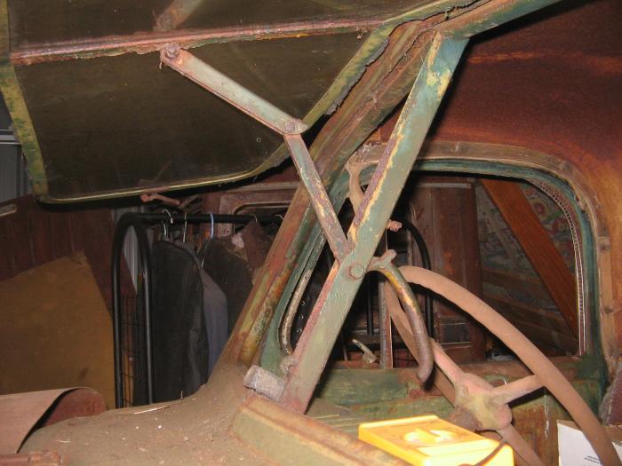

Default Front Pivoting Windscreen
Hello Chris & whomever asked me to post up some photographs of the windscreen,
I had to wait until the windscreen got nice and dusty to cut down the reflections before I could take photographs of it. Well that is my excuse anyway.
Photograph 009 shows the top hinge points and also shows the quarter vent window which identifies the truck as a Holdens built cabin as opposed to the single pane of glass for the Lend Lease side windows.
Kind Regards
Lionel

The Holden cab usually has a fixed windscreen, it's one of the identifying features along with quarter vent windows, the foot-well vent either side and the lack of top cowl vent.
Just goes to show the folly of making definitive statements. So many variations.
I don't remember seeing anything like the linkage for pushing out the windscreen on your truck Lionel. The American cab has a winder under the dash with a crank handle on top and pushes the windscreen out with a flexible stainless steel strip. It only opens six or eight inches or so.

Default An older version
G'day David,
http://www.awm.gov.au/collection/024625. Mine was definitely a militarised version as can be seen by a slightly younger version of my truck. Same windscreen modification. The description says "Australian Army"
The details of the photograph from the Australian War Memorial collection appear below
P.S I found another photograph from the AWM of a Chevrolet with the same type of windscreen.
Kind Regards
Lionel
