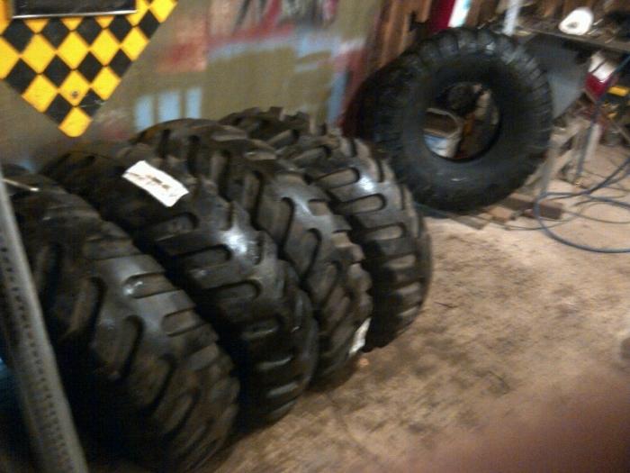

Grant has kept himself quite busy as well. His focus has been on the front end of his truck. Recently he painted the clip or nose of his CMP. The glossy undercoat does not do justice as it shows every small flaw in the metal. Of course Grant will fix those issues and by the time he shoots the final coat on, the truck will look like it rolled out of the factory.
Next up were the rims and tires. After sandblasting the rims, Grant primed and painted them. He then installed his new tires on the rims. The new tires look absoultely stunning mounted on his refurbished rims.

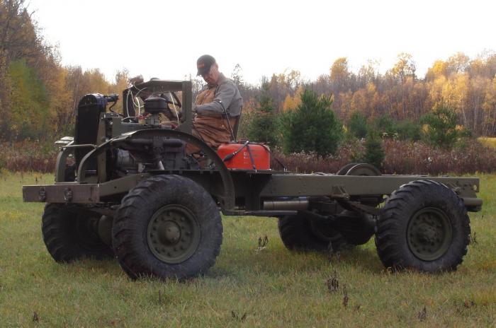

Not to be outdone, Bob too installed his new tires.
Most of us know that a lot of effort goes into a restoration. If you want to see how to fix and restore a truck to a near perfect state, drop in and have a chat with Grant.
Photos

Beautiful..
Tires are mounted backwards..open part of the "V" should hit the ground first..not the point of the "V"..
I thought we settled this years ago..
But maybe driving it in reverse is the way to go..

Default Tires...tyres...tired....
Hey Alex.....
Picture only shows two tires..... the other two are mounted the other way.... helps to get out of a mud hole frontwards or backwards.....
Honestly, after reading all the MLU postings and re-reading the various shop manuals which by the way changes from early to later in the war, I opted for the same direction as on the farm tractor...... which is suppose to ride smoother and incur less wear....... next time I rotate them ...say in 5 years or 5,000 miles.... I may orient them differently just to get comments from the other half of MLU.
Bob C.
PS.. We are still using our own barn designed invention to seat those tires on the CMP rims that are not supposed to accept USA tires bead design........ having some tire shop snoothy lub does help. tremendously.

...and to be sure.... we replaced both rear tires with the new 10:50 x 16 on the rear axle. Now the rear frame was even.... level within 1/8 of an inch.... whcih to me accurate in CMP language.

I just had to take it out for a run....... we spent so much time re-adjusting the shifting rods of the 2 speed T case..... had to find out if it worked .... and it did..... pictures attached....... T case now works fine and so does the winch. All that frame twisting on the wood chip pile did not mess up anything.
Going up is fine coming back down is scary. Being very light wheels spins in the wood chips as soon as you give it more gas...... and the chevron treads do throw out wood chips quite a bit.
In low range 1st gear truck will crawl up just at fast idle.
Coming down was another story....... blue smoke came out of the tail pipe like a smoke bomb...... oil rushes to the front of the pan and must get by the rings....... also notice some oil dripping from the fuel pump/engine block gasket area. More adjustments are needed...... one fuel line was also dripping and needed retightening..... but to reach it properly we had to remove the front floor panel....... it's like one step forward and 2 steps back.
