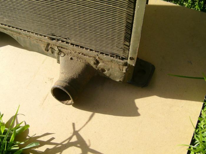

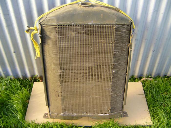

Picked up a NOS BGC radiator off EBay during the week.
This part has been hanging in a shed for 40 years as a spare for the Ford blitz that the old owner had on the farm. The blitz was sold off 10 years ago and the old owner died about a year ago, so the family are selling anything of value and tidying up.
The NOS radiator is painted Khaki green, never had water in it, the overflow tube and union is still to be bent to the right for the BGC overflow valve.
This is one item that I required.
