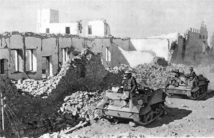

Hi, Painting one of the carriers in Caunter and want to get it right, I have swatches of the original colours and am looking for the correct places for the straight lines. What I want to do is pull together all known original photos together in this thread.
any pics you have please post.
thanks kevin.

Hi, Particulary interested in front and rear views.
kevin.

Thanks, I will contact him. Still be good to have a thread on Caunter pattern carriers, so if anyone has any they can post that would be great!.
It's also worth noting from the pics i have posted that the guys back then were not to bothered which way round they put the tracks on.
Would these all be British built carriers in Caunter?. No Canadian??.
kev.

One for starters.....its a good one as far as I'm concerned showing the back end and detail of a Bren. I'll look for some UC pics after the kids are at school.

A few more from an IWM collection showing a column of Brens with a universal leading after arriving in Crete. I like how the commanding officer seems to have the "new" universal and the rest of the unit have the older Brens. I've only included the shots showing the UC as the brens aren't in the caunter scheme. One of the ones you posted is the last in the series.
Your turn for some Scout shots now ;-)

Many photos of anti-aircraft guns show that the pattern was not applied, possibly because it is difficult for a pilot not to spot a gun that happens to be firing away at him, even if it is camouflaged!
1943 Mk2 Daimler Dingo.
1943 Willys MB.

Default MaltA Camo
More Pics.
