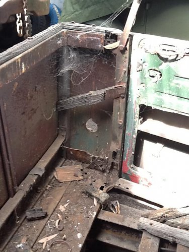

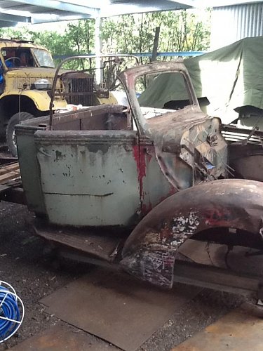

Just a few photos of the cab I have to work with. I do have another 39 hard cab which will provide some sheet metal and out of the two I should be able to resurrect one decent roadster cab. The original is very badly rusted but straight. The hard cab is not badly rusted but was involved in a accident at some stage and badly bent on the left hand side, pushing the cab out of alignment all across to the right side. Much of the sheet metal on the left side is unusable despite the damage being repaired albeit very poorly.

and some more showing where the chassis is at. It is almost a complete rolling chassis. Just needs a bit of paint and a bit more work on the front end. Also a photo of the rear body showing how bad it is. The other two photos show a patch over the vent and what I found underneath it. See what I am up against??

Just spent the last four days pulling the two cabs apart to salvage what will be reassembled to make one cab. Lots of cutting and grinding to get the good bits from one to replace the rusted out bits from the other. I will get them sandblasted and then reweld the pieces back together. The rear extension of the Aussie roadster cab is seen still intact. One thing with the 39 cab is the door pillars and other parts are riveted together first before some extra welds are added. This makes it easy when reassembling as you know you have the piece in the right place. Just line up the rivet holes.

The bottom section of the left side was cut out both because it was rusted and to open up the inner frame for sandblasting. A salvaged section from the hard cab was good enough to repair and refit.

These photos show the remains of the timber work which needed replacing. It would have been impossible to copy from these remains if I had not done the same job on my Marmon Herrington Gun Tractor a few years ago.
