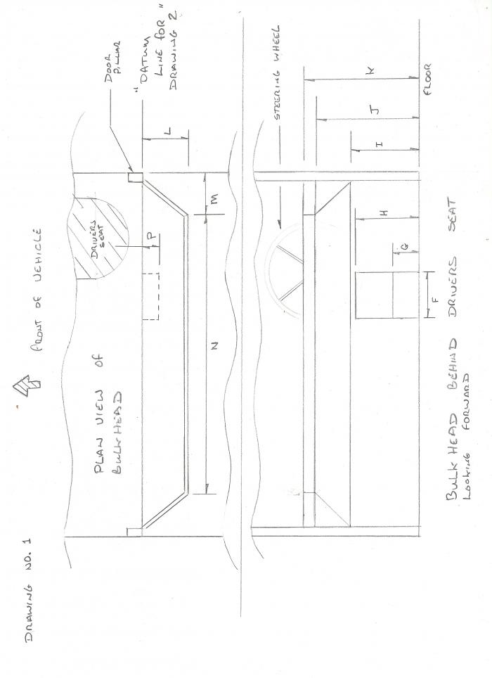

Well, to start with thanks for the offer and i mean a big thanks. Ive attached a couple of drawings if anyone can fill in the dimensions i would be very greatful. The drawing are not to scale and i hope that you can understand them. If anyone out there has any drawings of doors anything else they would all be welcome.
Jonathan

Could i ask someone to check a dimension for me if thats possible. I need to know what the dimension is from the cab floor to the top of the pillar behind the drivers door, to where the roof would sit. I dont know if mine has been messed with and i would hate to finish things and find out that the roof was 1" lower than it should be. Has anyone got details of the windscreen opening bosses, the ones that are attached to the outer frame two on the middle pillar and one on each outer post. And
Lastly if anyone could add some dimensions to my sketch i would be really gratefull.

Yes the windscreen frame does bolt in with the door hinges and two small bolts in the centre.
